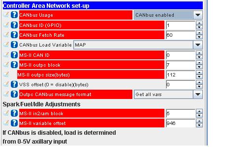

Am having trouble getting data (tach, load) from MS3 to MShift. Am running MS3Pro 1.2.4 and MShift 4.136. I've researched the how-to's best I can, setting up the Outpc etc. Attached is a screen shot of my setup. I have also included the MShift ini file. I am running MShift as CAN pass through.
Thanks for any help...

I re-loaded 4.136 code, and that solved it. Something must've been corrupted.
I tried loading the lastest code 4.137 and it works also.
