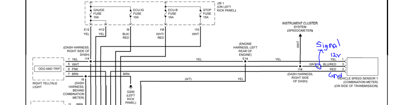

I need to double check the wiring on the sensor but according to the FSM (and previous experience/use with it) it is supposed to put out a 5v square wave pulse, which would be perfect. Something told me to check the sensor output voltage BEFORE connecting the GPIO to the harness and I'm glad I did. On the "signal" wire from the sensor I saw a resounding 12ish volts, despite that not being what it is supposed to do. I have a 5.6zener diode in the circuit inside the ECU but regardless...not cool
I'm running the VSS direct to the processor pin with a Jumper from bottom of R59 to bottom of R42.
Attached is the diagram for the toyota VSS

So I have it wired correctly, but there is something going on with the GPIO hardware. If I connect the GPIO ampseal connector, the sensor doesn't work. If I disconnect it from the circuit, it pulses an LED just fine.
Ideas?

Nevermind......DUR!!!!! Q13 was in the circuit still. Works fine now.
