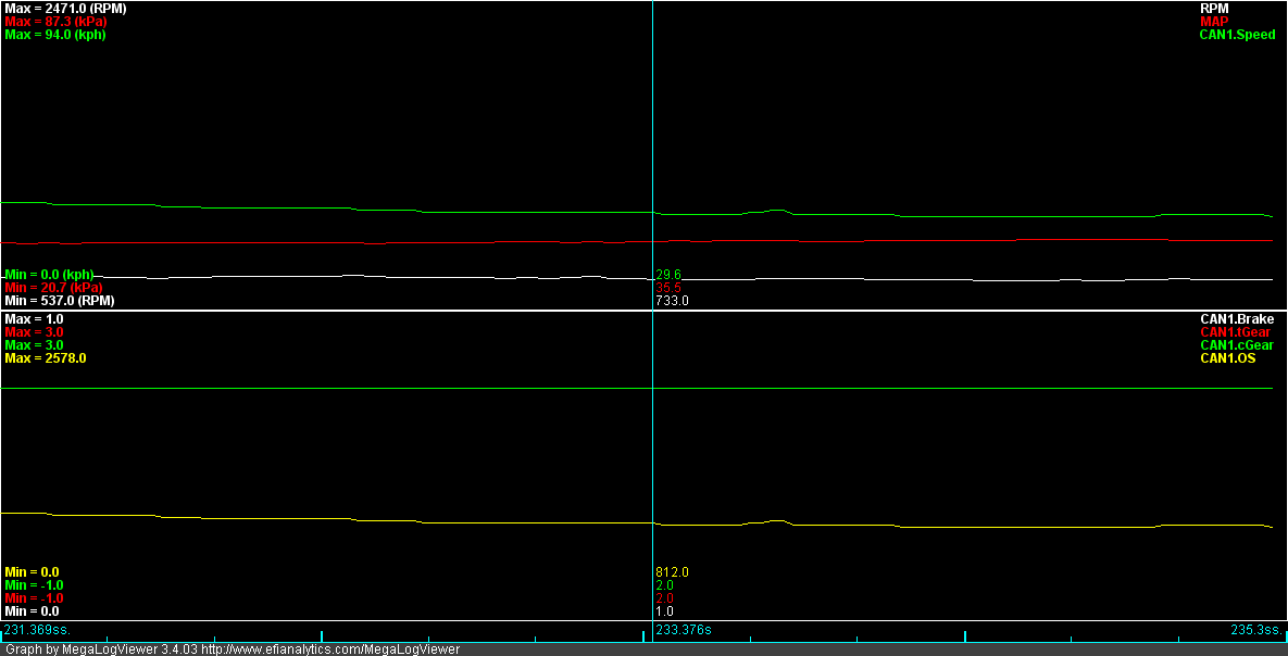

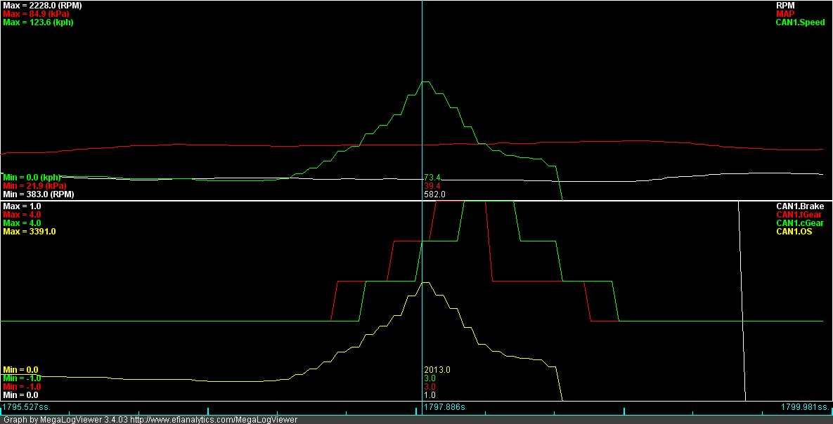

In this screen we can see that Im on the break decreasing speed and when just coming to standing still I get a huge jump in speed!

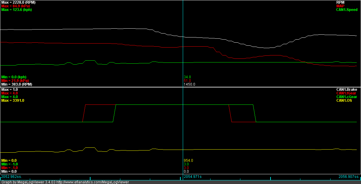

This is also a odd behaviour, cant see any reason for the upshift to 3rd not even close in my shift table either....actually MAP is decreasing

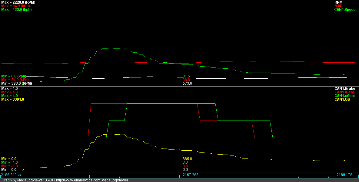

Here we can also see when taking off from standing still, the output speed accelerates by it self....well if the car really could do 0-50kmh in 2 sconds I would be very happy

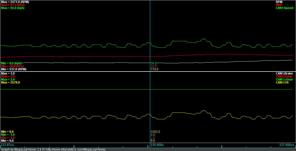

Here is another one, seems like the signal start sp self oscillate.....
and then completlty smooth......

I can't say why the unexpected shift happens without a full log (not a screen shot). The log contains much more information about what the controller is doing and why than any screen shot, and is much, much smaller (if you only post the relevant section(s), at least).
I also can't see whether you are accelerating or decelerating from the pics, I can only see the VSS signal (braking or not can be misleading, because some people do use the brakes when the wheels or accelerating, such as during a burn-out, etc.). So it's better if you post a short excerpt from a log and then describe exactly what is, or isn't, happen in that section of the log (ideally with references to the time stamps).
