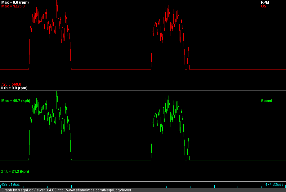

I redid my output shaft sensor wiring using a shielded cable as indicated in the manual to try solving the problem. but it comes again.
When I analysed the logs, I saw that the error always comes at an OS speed of 1960 RPM (approx 70km/h).
The VSS falls and Megashift shifts in 1st gear and then up again to 4th
I checked the max error to reset: I am far below that limit. I suspect something else as it occurs always at the same output shaft speed.
here are 2 pictures of logs and my msq. (between the 2, I changed the tire diameter parameter, that is why the speed is different for the samo OS speed.

2 more screenshots

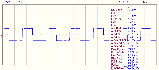

It seems I have the same problem here Ive been using the function generator on my scope to simulate the vss signal coming in to the GPIO.
What I can see is that at 500hz and at 1300hz I get a lot of "noice" in the GPIO signal.
At 500hz the siganl is very jumpy looking at the TS log even though the signal coming in is clean, as soon as I put the scope prove on VR1 at the 25pin header it sits straight, see log and also scope pic below taken at the VR1 at the 25pin header
Since the signal coming in to the processor is clean I assume that the code/software filters is self creating these oscillations??
