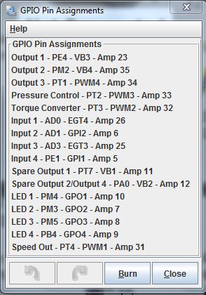

I built my GPIO board to the 4L60E Trans specs as it resembles my Audi 094 trans in general operation. Except that The Audi 094 has 7 solenoids. 4 of them are gear solenoids, 2 are Clutch solenoids, and 1 is a Pressure Control Solenoid. The Pressure control Solenoid is the only one that will need PWM. So, I was hoping someone could help me figure out how to setup my output solenoid controls as follows.
Output 1 - VB1 - Solenoid 1
Output 2 - VB2 - Solenoid 2
Output 3 - VB3 - Solenoid 3
Output 4 - VB4 - Solenoid 4
Spare Output 1 - PWM 2 - Solenoid 5 (use as shift Solenoid)
Spare Output 2 - PWM 4 - Solenoid 7 (use as shift Solenoid)
Output 6 - PWM 3 - Solenoid 6 (use PWM)
Seems like it would make more sense. The hardware is already setup for this, I just don't know where to make the appropriate changes in TunerStudio MS. Will this require a change in the embeded code of the GPIO?
I am running MShift software version - GPIO_MShift_2202
Thanks in advance for the help.

As always, Thank you for the quick response. The problem is that when I set Spare 1 and 2 to Clutch outputs, I lose a shift solenoid (3 shifts and 2 clutch) and when I set them all as Shift solenoids, I am still short one shift solenoid. Thanks to the TransStim, I was able to figure out I am not getting an output signal from VB2/Spare Output 2 and no response from my TCC output. All other outputs look to be working fine.
To clear up my original question. I would like to configure VB1, VB2, VB3 and VB4 as Outputs 1, 2, 3 ,4 and leave my Spare Outputs 1 and 2 to control my Clutch Solenoids. It would make more logic for my application. If not, I will try to work around it.
P.S. My Pressure Control is working great, so that solenoid does not need any further mods.
VB2 issue.JPG (43.73 KiB) Viewed 27599 times
KamikazeTuner
Posts: 9
Joined: Tue Aug 28, 2012 10:25 pm
Re: Audi 094 4 Speed - Solenoid Output
Post by KamikazeTuner »
I just noticed a HUGE mistake in my part. When building the board, in particular jumping the 25x2 headers. I accidentally jumped AD1 to VB2 instead of the correct method of AD1 to GPI2. That explains why I an having all these issues with Inputs and Outputs. I will correct it and report back.
