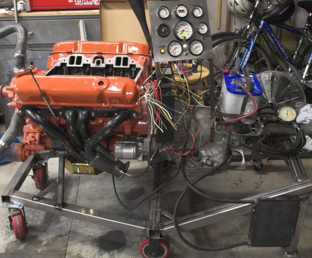

ps- here is a pic of the stand I'm building to test everything while the car is being painted.

That's a nice rig! ! !
Turbo Neon, converting to 41te trans sometime?

Thanks tjabo, I'm hoping that I can get the engine and trans stuff in the ballpark before the car comes back and do final tuning in the car.
