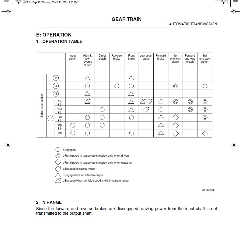

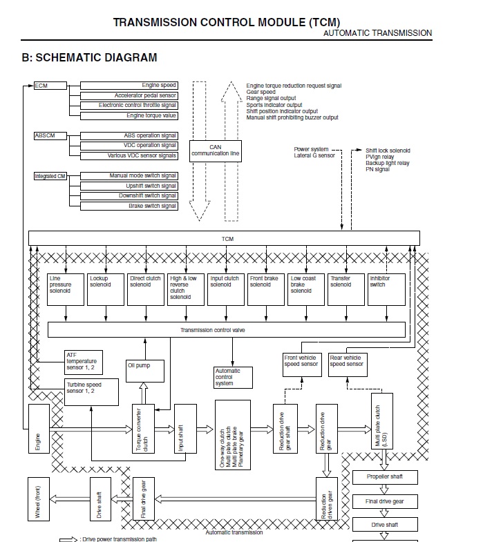

Could you please help me understand how there are only 5 driving solenoids (not counting line pressure and tcc), but 10 total driving solenoids/brakes (6 clutches, 4 brakes) listed in the manual? How are all these different functions controlled and performed?
On the Valve Body:
Input Clutch Solenoid
High & Low Reverse Clutch Solenoid
Direct Clutch Solenoid
Front Brake Solenoid
Low Coast Brake Solenoid
Others listed in the Operation Table:
Reverse Brake
Forward Brake
1st One-way Clutch
Forward One-way Clutch
3rd One-way clutch
Thank you,
David

I don't know anything about this particular transmission or it's manuals, but trans manuals often list the solenoids and the mechanical parts (brakes and clutches) they control together. The only part the controller works on is the solenoids, and these then control the clutches and brakes (either directly or by applying/releasing hydraulic pressure).

I did more research:
There are 4 mandatory shift solenoids. Additionally, there is a 5th one that activates "more aggressive" engine braking in 1st and 2nd gear, mostly in Sport Shift Mode. I'm going to do some soul searching to see how much I want that 5th solenoid, as it would be hugely helpful to have that Spare Port available to actuate something only during each shift (the aforementioned pressure dump solenoid that will temporarily cut manifold pressure so the car can shift without 500chp entering the transmission).
Hopefully the stock TCU can be left in place. The hope here is that the MegaShift would be a piggyback, controlling all shift function, TCC and line pressure. The stock TCU would hopefully still control the center diff, and keep the other systems happy with a CAN VSS signal. It will be interesting to see whether the TCU can be kept from pulling timing during shifts, while still allowing center diff clutch function with the Lateral G sensor. Worst comes to worst, I will create my own Center Diff controller, or just use a switch like Frank.
