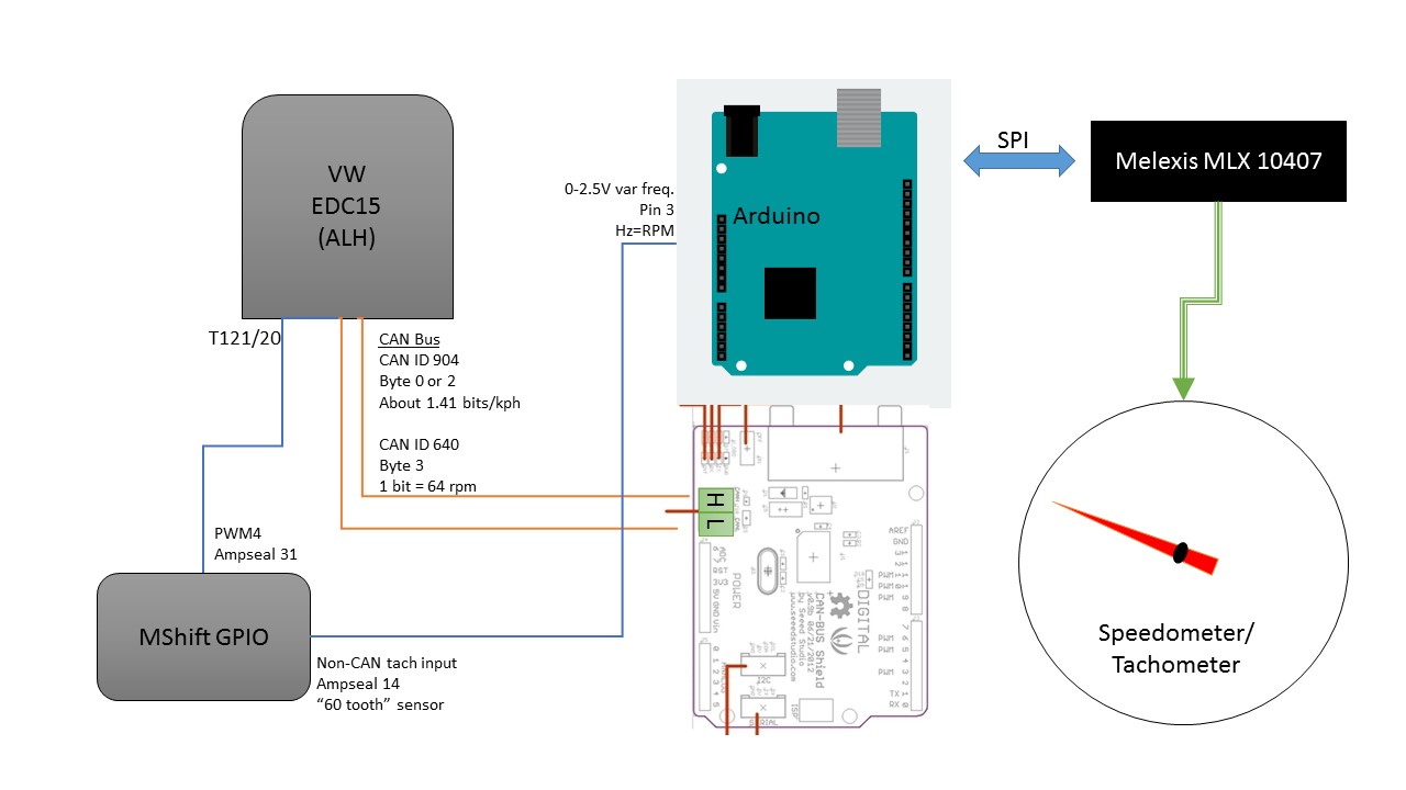

This is my arrangement for the VSS & Tach signals. A little convoluted but its mostly working.

4. If I build up VR3 as in the last paragraph on this page, will that work for reading a 0-2.5V tone?
http://www.msgpio.com/manuals/vr.htm
5. Do you see any issues with the above scheme for VSS & Tach? The VW EDC15 is expecting a 0-5V signal where Hz= speed in km/hr. In the Jetta/Golf setup, the Instrument cluster would read the VSS, apply conditioning and scaling, then send to the ECM. I know the 0-5V signal works because I can do it bit banging an Arduino. I would have the Arduino read the speedo signal from the Mshift, but the ECM needs road speed to make all the OBDII features work.
6. Give above scheme, do you recommend building the PWM4 circuit per the instructions or doing anything different?
Re: Need some help with Load & tach in a diesel
mcneil,
That should work. Building it as a VR circuit should work too. So you could do it either way; if it was mine I would build the digital input as it's a simpler build without the closely spaced transistor leads.
I don't see any obvious issues at first glance. However, I am not sure what sort of output frequencies you will need, and the scaling will need to be appropriate. There is more here:
http://www.msgpio.com/manuals/mshift/V5tune.html#s
and a speedo output ratio calculator here:
http://www.msgpio.com/manuals/mshift/V5tune.html#ag
The standard build should be fine for this usage.

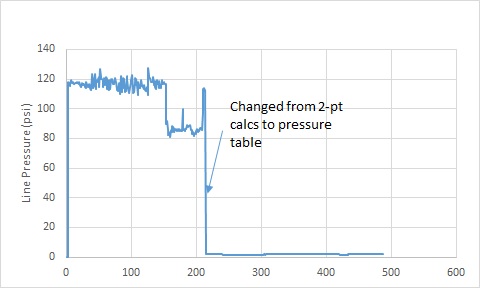

Lance, I think there's a conversion error somewhere in the line pressure table. I get good data on 2 point calcs, but the table is off by about 100
mcneil,
Here is 5.104ti test code that multiplies the 2pt line pressure by 100 (it changes a "/10" to "*10" on one line of the 2pt calcs):
Monitor_5104ti.abs.s19
Uses the regular 5.104 INI file
(84.44 KiB) Downloaded 1554 times
I have a bad cold right now, and between that and what I am taking for it, my head isn't all that clear (well, actually it rarely is, but it's especially impaired at the moment!). So I don't want to try anything too drastic in the code is this state. If you wanted to try this code and see if it helps, that would narrow the issue down a lot.
mcneil,
I misread your post. I just realized that it is the regular line pressures that are 100x too small, and the 2pt calcs are okay (assuming I am now correctly following what you have said). So don't use the code posted above.
Instead, try this if you like as it seems to work on my bench:
Monitor_5104tii.abs.s19
Uses regular 5.104 INI
(84.53 KiB) Downloaded 1596 times
mcneil,
I think the code above might work for you, but I think it will mess up people that are using metric (Bar) pressure units. So this code should work for both (I think...):
Monitor_5105.abs.s19
(84.52 KiB) Downloaded 1612 times
