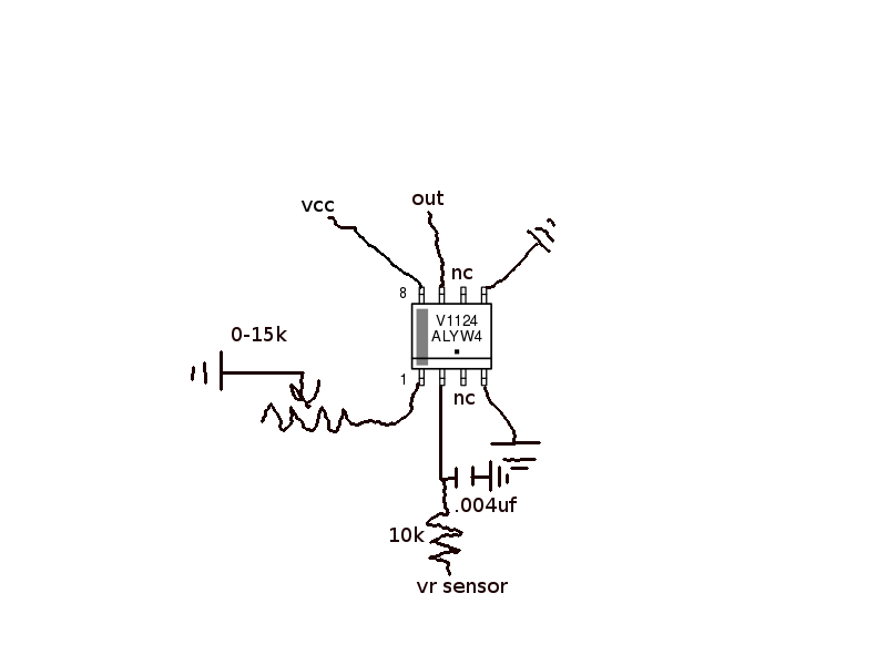

the 1124 circuit i use is extemely simple it uses only 6 pins on the 8 pin ic and works well with both my 4r70w(6 hole vr) and 4l80. i can post up a pic of it if necessary

this is what i used on the 4l80 the 4r70 was the same except the capacitor was a .02uf
http://www.onsemi.com/pub_link/Collater ... 0SHEET.PDF

That is a very simple install, unfortunatly that particular circuit is very difficult to find here in Sweden even in Europe...
For sure you can get it from Ebay I guess, DigiKey and others do have them but then you spend USD1 for the circuit and USD100 on freight...
I assume you still need to do some trimming on the resistor at pin 1?
I'm also very afraid of using capacitors on the input circuit (VR input) since they are a source of possible self oscillations(that is what happend with my 555 Schmitt trigger)
As I understand you will also need to trim the capacitor value?
Otherwise its a super simple circuit possible for most home electricians to build.
Can you post any log, would be very interesting to see how your OS signal looks.

tobmag wrote:Ashford.
the capacitor is optional as a low pass filter, i did the calculations for about 150mph. the variable resistor is suposed to be the same as Rsensor +R1 since i didn't have a 12k ohm resistor i used a variable, it also seems to have an affect on hysteresis.
i looked and coul'd not find old before logs but have a few after logs, basically the speed would slowly rise by itself when stopped and jitter all over the place when actual speed was below 30mph.
