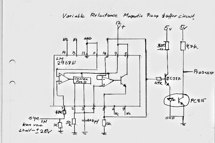

I have also ditched the 555 Schmitt trigger and now using a new circuit based on LM2907 http://www.electrokit.com/productFile/download/931 and a optocoupler on the output to the processor.
Will post the diagram as soon as I have it made up electronical. ( Circuit designed and built by my 73 year old father :shock: )
This new cisrcuit is rock solid from very low frequenses, around 20hz and up without a single glitch.
I will build the Schmitt trigger as soon as I get some components that are missing and then I will post some logs here using the original VR circuit, the new Schmitt trigger, a circuit based on the MAX9926 (same as gui76 uses) and my new circuit.
Attached a log live from the car where we can see the new circuit in action.....
Posted: Tue Sep 24, 2013 12:23 am
by tobmag
And here is the schematics;
Just to clarify on the input, voltage can be with this configuration between 20mV and 28V rms (~80Vpp)
picupp omvandlare.jpg 2.jpg (171.5 KiB) Viewed 27277 times

I can only talk on behalf on what is happening on my installation with my 4L80E, I have followed all instructions when it comes to shielded cables and routing etc.
Exactly where the problem is if now only related to the 4L80E I can’t tell either, would be very good if others could chip in their experiences with other transmissions here.
What I have seen so far is that whatever you build and test on the bench doesn’t necessarily work in the car.
For instance my 555 Schmitt trigger works as a dream on the bench but as soon as it came into live action in the car it was useless....
This is actually where my father came in since he has over 50 years’ experience with electronics and the last 20 before retiring he was building/installing test equipment at Volvo at their engine test cells.
He had many issues with VR sensors over the years and usually a Schmitt trigger would work fine, in the severe cases they used the LM2907/opto coupler, but again whatever was built on the bench didn’t always work in the test cell...
I’m not in any way saying that this is the final solution but so far its working very well, it also comes in a 8dil version so it might be possible to fit it directly on the board.
However I will still build the Schmitt trigger you posted and also test the MAX9926 and also look at the circuit that "gboezio" posted but that will be in a few weeks, right now I need to tune transmission and engine as much as possible before the snow comes.
