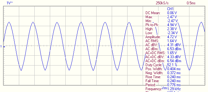

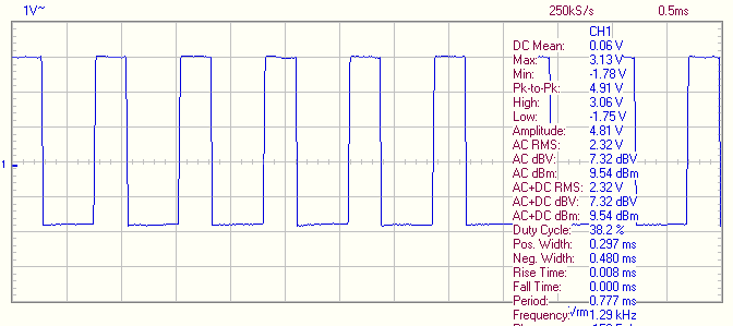

Did some more testing today with the new function generator I borrowed.
I can replicate the problem at 1300hz(+-100hz) everytime, I have made a new log that is attached making a sweep over 1300 and back a few times.
With 1300hz I mean what I put in at the pigtail, actaul VSS frquence in TS is usually of by 40-60hz(always less)
I attached the scope image of the signal I put in at the pigtail and also from the VR1 at the 25pin header.
(45.25 KiB) Downloaded 1064 times
at the header
at the header
vss1300hz vr1 25pin header.png (9.49 KiB) Viewed 20081 times
at the pigtail
at the pigtail
vss1300hz input.png (10.67 KiB) Viewed 20081 times

I tried your latest MSQ, and I can't generate the sort of behavior you are seeing.
Your 5V square wave screenshot shows a range from -1.75 volts to +3.06 volts at the 25x2 header. Is that correct? The processor PT0 I/O pin should not be seeing voltages lower than zero (with -0.3V as the absolute minimum according to the datasheet). This suggests to me that something isn't right in your test set-up or build.
Is the scope grounded properly to the same ground as the GPIO board? Is the signal generator also grounded to that spot?
If this was mine, I would also look over the VR1 circuit very, very carefully. It is easy to get the transistors in backwards, or bridge the pins with solder or flux.

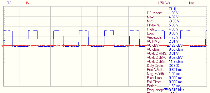

well if thesignal coming into theprocessor is DC I had the scope in the wrong coupling, had it set for AC.
Below in DC coulping at the 25pin header.
vss dc.png (9 KiB) Viewed 20070 times

Yes all grounds to the same place, did a quick test and used ISS as VSS input just jumber VR3 and PT0
Same thing going on at 1300hz if the filter is on.....if I turn it off its (almost) 100% ok.
Re-checked all components and orientation of the transistors, only thing that is not according the build instruction are the transistors that are named 2N3904-A47
Instructions says 2N3904FS-ND
