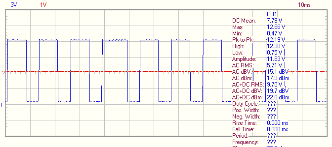

I have done some testing now with the 4136 code but that didnt help...
What I can see is that the output signal is still to noicy.
I also noticed that at about 1000hz I didnt need to change the time devider on the scope, that means to me that the frequency doesnt really change.
Made test with different duty cycle but makes no difference for the speedo, still only goes upto 140kph and starts moving backwards...
Frequency mentioned is input hz to the GPIO

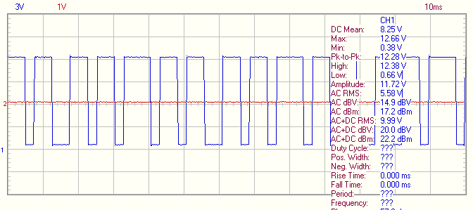

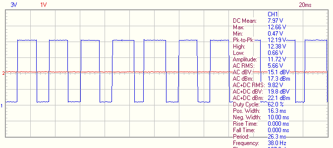

Re: Speedo out erratic
Posted: Thu Jan 30, 2014 11:30 am
by tobmag
Some more screens, 2000hz looks very strange but was constantly repeated,,,
