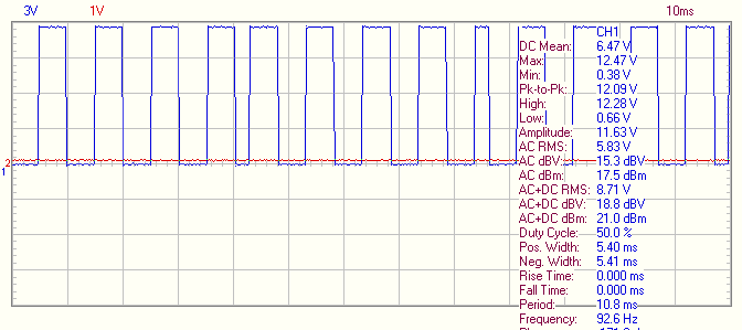

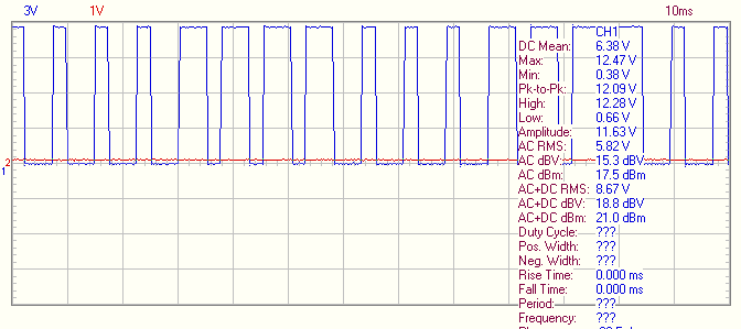

Problem is that I cant get the speedo to run to more then 160kph, I thought it was related to the compatability of the out put signal and a 30 year old Electronic speedo.
This is not the case and what I can see looking on the speedo signal is that the duty cylcle jumps all over the Place, I have attached some scope shots displaying this.
The higher the frequense the worse it gets and at 160kph my speedo starts going back wards....
I have a tacho for diesel Engines laying here so I tested that one as well, this particualr gauge uses the "W" signal from the generator so it also frequense based, same thing here workes up to a sertain level and then it whent back wards as well.
As you see my scope has problem picking up the frequncy as well...
Running latest 4135 code.
ok duty cycle
ok duty cycle
poor duty cycle
poor duty cycle

Done some testing now on the bench using my signal generator.
Tested changes in the filtering and out put pulses but no changes.
Speedo still just go up to 140kph and then starting working backwards.
My speedo is very stable and liniear, did some test directly with the signal generator and is then working fine!
65kph at 90hz
130kph at 180hz
260kph at 360hz
Tested with a sine wave and then swapped over to square vave to simulate the GPIO signal and then started to play with the duty cycle.
My speedo is working down to a duty cycle of 10% but will stop working as soon as the duty cycle is over 60% !!
I then tested my tacho I have laying that is for diesel engines, signal used for that one is the "W" signal on the generator so its also sine wave.
This one showed the same behavior connected to the GPIO, starts going backwards at a sertain point.
Tested this one as well directly on the signal generator with the square wave and this one will stop working at a duty cycle of 70% !!
So I assume that something goes wrong with the output signal from the GPIO giving a way too high duty cycle at higher frequenses.
