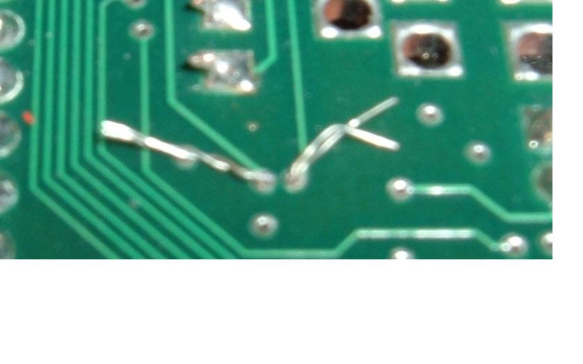

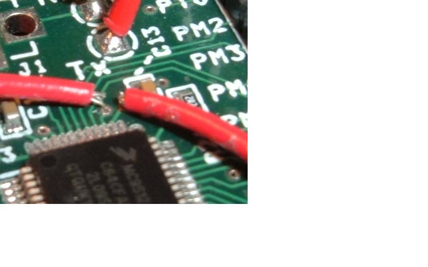

after a couple hours tedious screwing around I finally got 2 wires inserted in the tiny vias near CPU pins 38 and 39. I found some 26 gauge stranded wire in my old wire box. turns out if I cut off all but two of the strands and struggle awhile I can get them to go thru the via. here's a couple pics but not soldered yet. not at all sure my current soldering iron is fine enough to do this without bridging or making some similar mess. Guess I'll find out. Do one from the top and the other from the bottom?
[edit] Pulled the pics, need to re-group on the close up digi-pics. Too bad about my 35mm stuff, I had a nice 50mm macro with extension, life size negs no problem. digi cams that get close to this are expensive.
Here's another try on the pics

I did manage to get the 2 strand wire soldered into the tiny vias near the processor. When you say "MS-II/V3 and GPIO serial circuits are electronically the same" how much the same are they? In the instructions for the USB converter device they mention pulling the RS232 IC if it's socketed. Mine is not socketed, could I disable the the IC by cutting the power leg? I think it's PIN1 where the dot is. I see traces leading away from some of the other pins.
