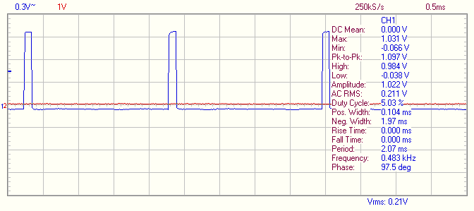

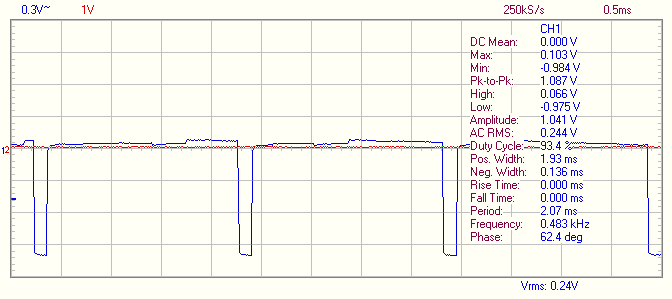

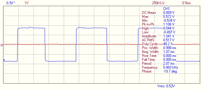

So here are 3 more scope screens now showing a proper pwm signal, this is measured at SP1 on the Trans Stim
Please note that PWM% seen in TS and Duty cycle seen in my scope screen are inverted!!
