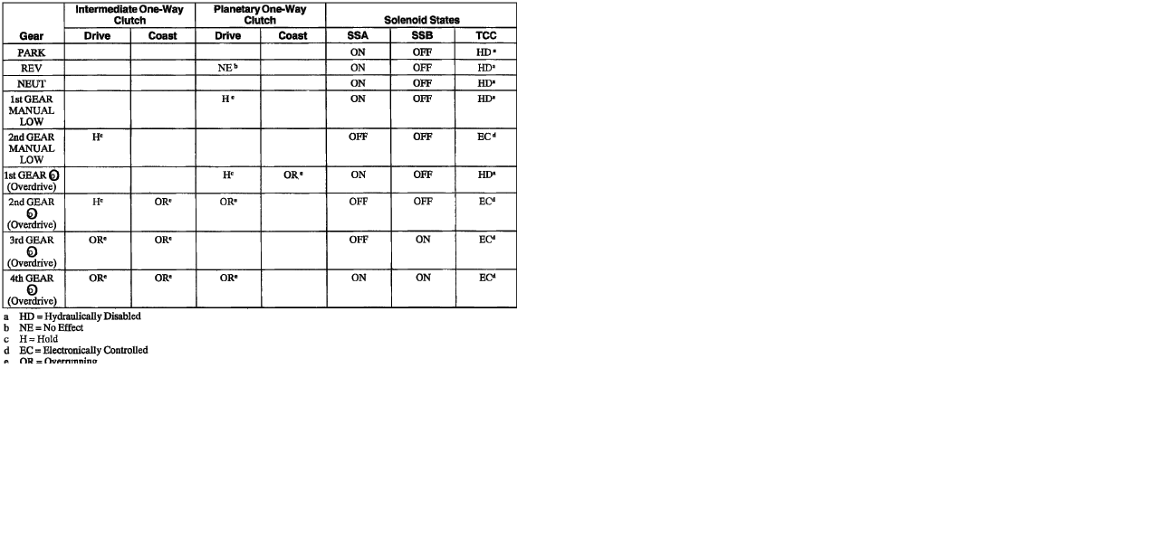

i figured i would post this since i couldnt find it on the net. a screen shot from mitchell
shift pattern4r70w.png (48.12 KiB) Viewed 25836 times
