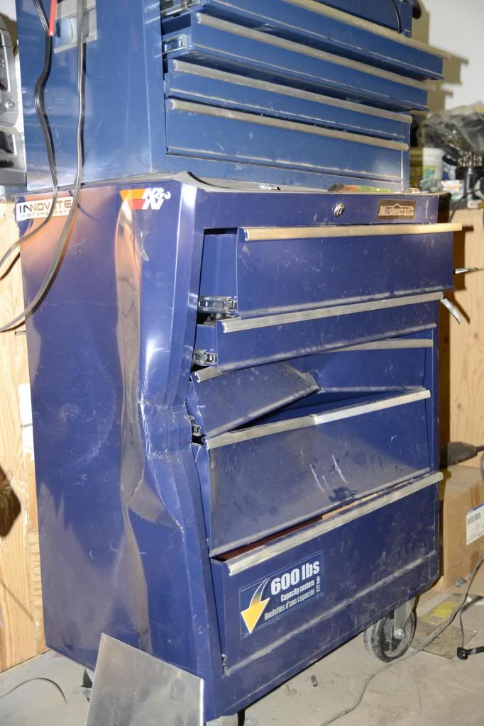

Also, I want to tell others to retain the safety devices of a stock transmission, reverse lock, no start in gear ask my toolbox !
I will use the shifter switch as a no start switch
I have started the truck standing on the ground leaned on the seat, but I previously had to pull the shifter to D1 to open the electronic box, cold idle was set to 1200, BAM !!

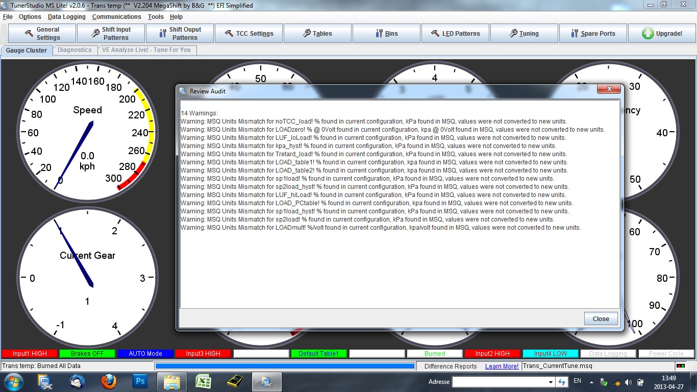

Here the long story, I have tried to reflash the TCU again trough the CAN bus, if failed again upon power cycle, but the controller act normally as I put in bootloader and off, then i configure with a temp trans file, then I power cycle no problem, then I use the main tune to reflash (trough can from ms3, power cycle and bam failed 3 times already, the timing is too perfect to be a accidental bootloader (pin to gnd) and I have the wires in my hands right now, but maybe the controller can go in bootloader from CAN ??
Now I have burned the whole tune trough RS232 and it worked I can power cycle at will.
But, at first I had 14 units mismatch error messages (all about units), I have power cycled, shut both TCU and TS, opened back again a single setting was left to burn, TPS or MAP_PC (sorry memory failed to exactly remember), I agreed to burn and now it's fine, some settings I have changed yesterday burned trough CAN makes the controller lockup.

Reflashed 2204 monitor, opened temp transmission project, burned current tune trough RS 232 TCU input, 14 errors (see screenshot), power cycled TCU and restarted Tuner studio, one difference left VSS_PC table, I agree to burn it burns and the whole tune is in the controller.
Hope it helps and have a great week end
PS I get none of the 14 errors burning trough the CAN bus, maybe it is why my units are all messed up and the lockup can come from the same problem
