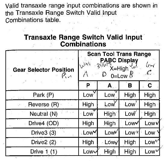

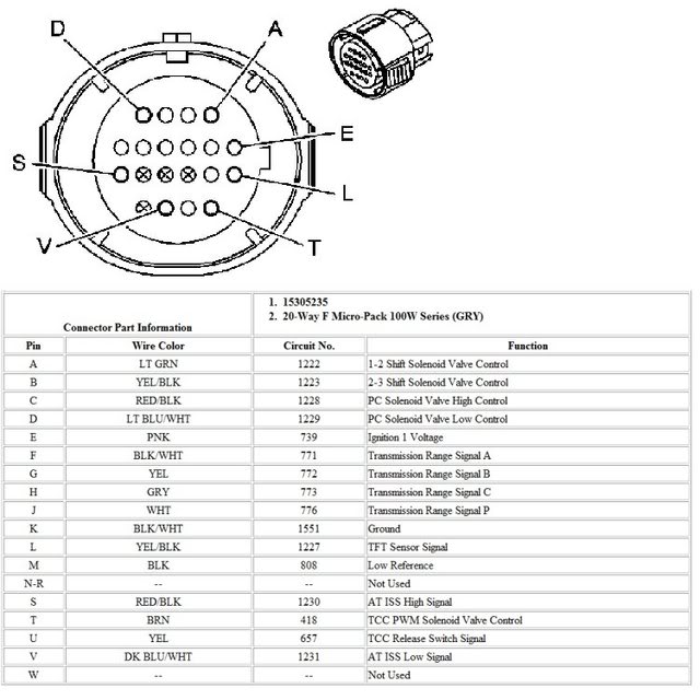

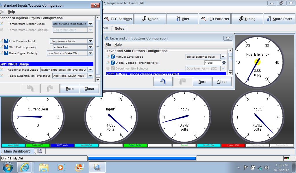

I got the manual shifting to work right just still cant get the inputs to work. I attached a picture with the range selector info. It use four inputs, so i have the 4th input enabled and inputs tables set to what they should be but still nothing. so i tried just grounding the input wires directly still nothing... maybe im missing something. i posted a picture showing all the input volts and all the inputs (low/high) when sitting in park(which doesnt change in any gear)
I posted a wiring diagram for the tranny and the only differences are the input wires which i have set to what mine is and it works on the tranny check ohms between the input wires and ground and it follows the table i posted.
The other difference in wiring is pin S which is for the 3-2sol which my tranny doesnt have its used for an iss but i dont need it and so i left pin s unhooked

The stim is the best way to test the circuits. Once you get the stim built, you should be able to tell what is going on both in the controller and the trans. Then the best way to troubleshoot the circuits if there is a problem on the stim is to compare the board and components to the build instructions and schematics.
