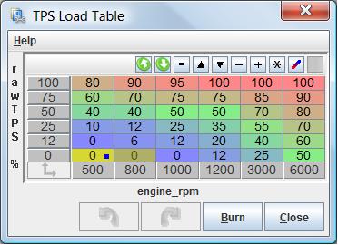

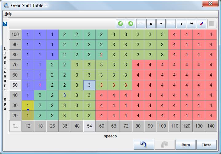

Martin,
Thanks, that is really useful feedback! I am going to put an option in the code to let users skip the jumps in load when it rises (so that it will rises the same smooth way it falls).
In the meantime, there are a few things you could try:
- you could adjust your TPS table to be more 'flat', perhaps something like this:
this will greatly reduce the jumpiness of the load due to TPS movement especially at lower rpms.
- you could adjust your shift table to be less dependent on load, maybe a little like this:
so that you only have 3 load 'zones' and try to put the breaks between the zones (50 kpa and 80 kpa above) where you drive the least.
I think I now understand the 3-4-3 issue. I believe it isn't a 'simple bug', but rather that code is working as intended, however the settings needs to be tuned and the code should be tweaked to handle certain situations like this better. In particular, I think the changing load (especially MAP) that occurs when shifting from one gear to another is pushing the target gear to another part of the table. We will fix it, though!
