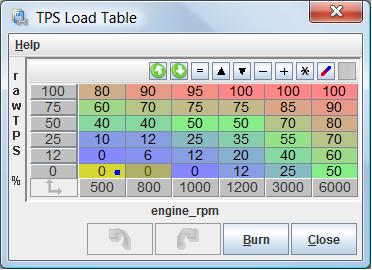

- you could adjust your TPS table to be more 'flat', perhaps something like this:
this will greatly reduce the jumpiness of the load due to TPS movement especially at lower rpms.
