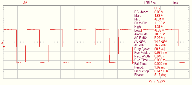

Speedo out to drive DC motor
Re: Speedo out to drive DC motor

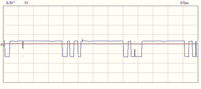

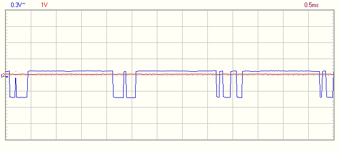

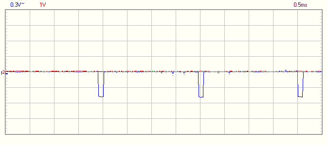

60% to 80%...

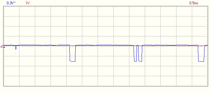

and the last 90%-100% well cant get over 97% actually....

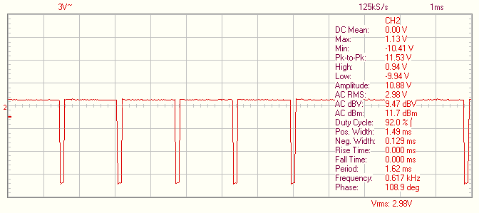

And this is how the PC signal looks like, perfect....
Measured at the Trans Stim.

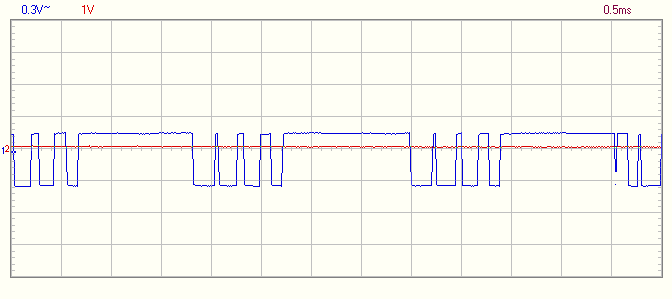

tobmag,
Are these shot while shifting, or in a 'steady state'?
Those are on a steady state

Okay, I will have a look on my bench shortly. Lance.

tobmag,
These scope shots are all on spare port SP1?
Also, can you post the MSQ of the MShift settings you used to when you made these shots? Thanks!
I see a problem on the bench. The PWM works as planned - except that the off period isn't fully off (it fluctuates between off and on). That is leading to the 'jumpiness' you are seeing. I will dig into the code shortly to sort this out. Thanks for your patience on this - it's how the code gets fixed.
Lance wrote:tobmag,
All exept the last post that are on PC out put.
