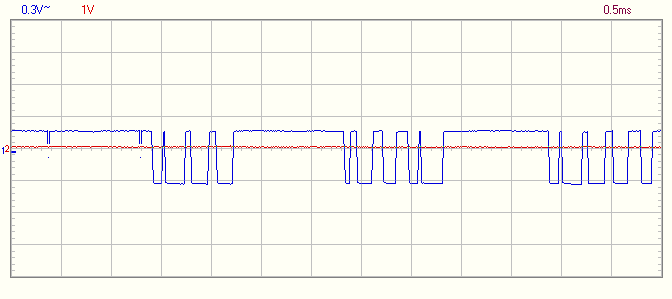

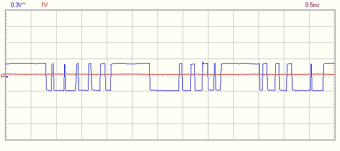

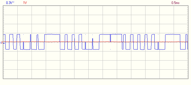

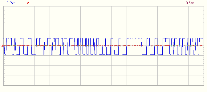

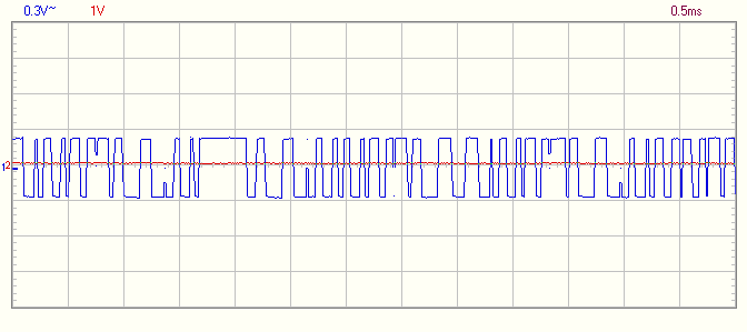

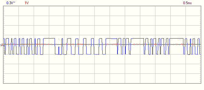

Got the scope finally and did some measuring directly on JP7, jumper removed.
pics showing outcoming signal 0-100% pwm.
Seems to be a very noisy jumpy signal....
PWM period 2ms

I only zipped the files due to the limit of 3 att/post.
Yes I did try different PWM periods but no difference.
Re: Speedo out to drive DC motor
30-50% .......
