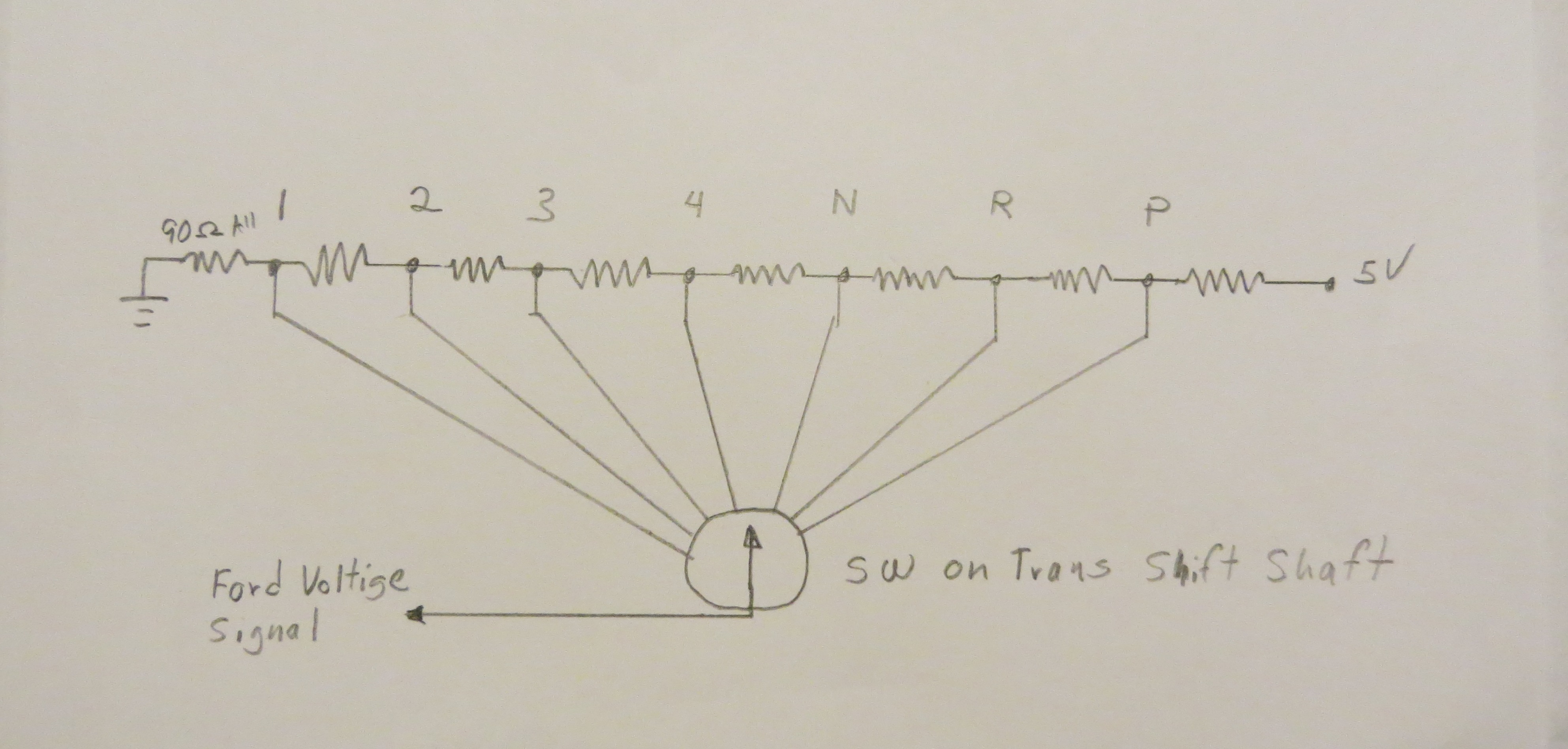

I thought i had read your instructions correctly and I did and I changed the gear setting back to 4 and before i finished I changed it to 8 out of curiosity to see how long it took for the trans to engage, 5 sec. sorry for the confusion.
Iv'e added a crude schematic of the lever position switch with resistors.
shift sw schem.jpg (1.17 MiB) Viewed 40815 times
Re: 5.101 config issues
camomcharo,
What are the values of the resistors in your diagram? Have you measured to voltage signals, or are you relying on the MShift signal for that?

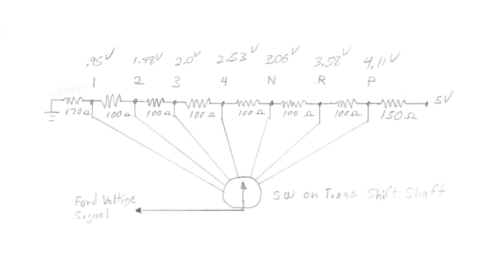

I've added more info hopefully its what you need.
The log is from shifting from park to 4th and back.
The volt values are at the resistor connection points with a fluke.
