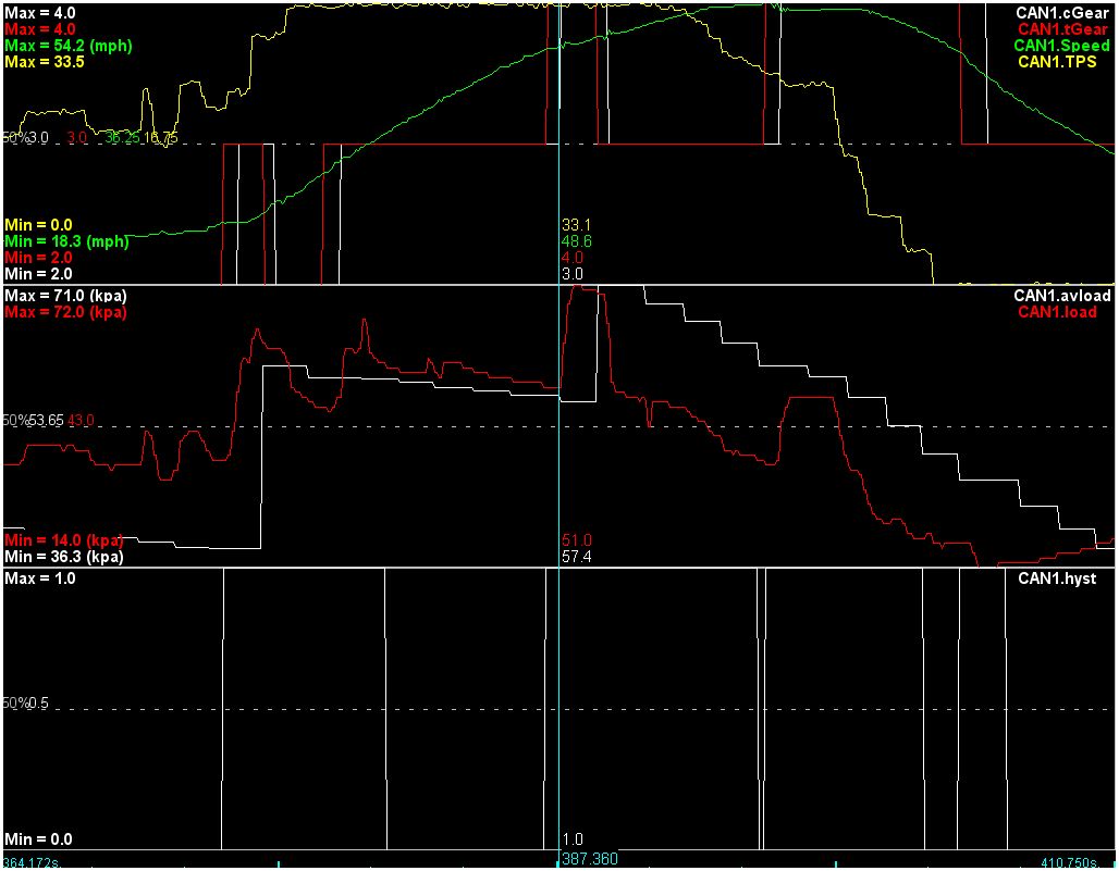

The reason I think that the TPS may work better for you (and possibly everyone) is that your load jumps when you get to 4th gear and this is causing the shift back to 3rd:
The load jumps because you have essentially the same throttle opening, but a much lower engine speed, so the MAP has to rise.
I think what is happening is that this increase in the load after a 3-4 shift breaks the hysteresis, so the 4-3 shift happens right away. Because it happens right away (in milliseconds or less) the chance of capturing the hysteresis = 0 in a datalog is slim (which is about every 70 milliseconds or so). The load decreases after the unwanted 4-3 shift, so there's a subsequently 4-3 shift which sticks because the load is lower (most likely because the TPS has dropped because of the driver's natural reaction to lift the throttle after the strange shift).
I believe this is caused by comparing the hysteresis value to the pre-shift conditions, and the really ought to be compared to the post-shift conditions (once they have stabilized). In the last code I posted, I avoided grabbing the hysteresis values until after the shift had been completed. I will modify the code to the grab the hysteresis load and speed values after a delay, so that it better reflects the conditions after the shift rather than before the shift.
In any case, however, the TPS is more stable over the entire pre-shift/post-shift period (you can see this in your log), so it's less likely to cause 'shift bouncing'.

In looking at the log you posted, I can see that the avload (the short-term average load) is slow to respond to changes in the instant load during a shift. It takes almost 2 full seconds. So the delay I introduced in the most recent code likely won't be sufficient to solve the issue you have pinpointed.
What you might try doing is reducing the 'load smoothing factor' under 'General Settings -> Throttle and Load Factors -> LOAD Smoothing Factor'. If it was 3000, you might try 1000 or even less.
