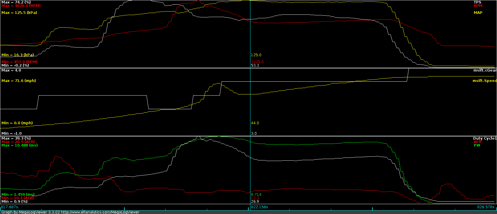

YES IT DOES, pics below
Lance wrote: Of course, if you can clearly demonstrate, based on a full understanding of how the shift table works and illustrative datalogs, that mixed indices are better, and that they can solve a specific problem shown in datalogs, then we can revisit this. In any case, the mixed indices will stay in the 4.1xx code (which will continue to get bug fixes), so you can use that for as long as you like, of course.
here is a pic of what is desired behavior for my setup at half throttle full torque.
note that the map increases as i let up on the throttle. i am at roughtly 50% throttle when boost comes on as that i wan about half of the engine POWER not torque. if this was map based it would of downshifted to the lowest possible gear giving me all the POWER available from the drivetrain. if i wanted more power to the wheels i would give it more throttle and then i would have more engine rpm with the same torque since power product of torque and rpm.
i hope this better conveys my reasoning.

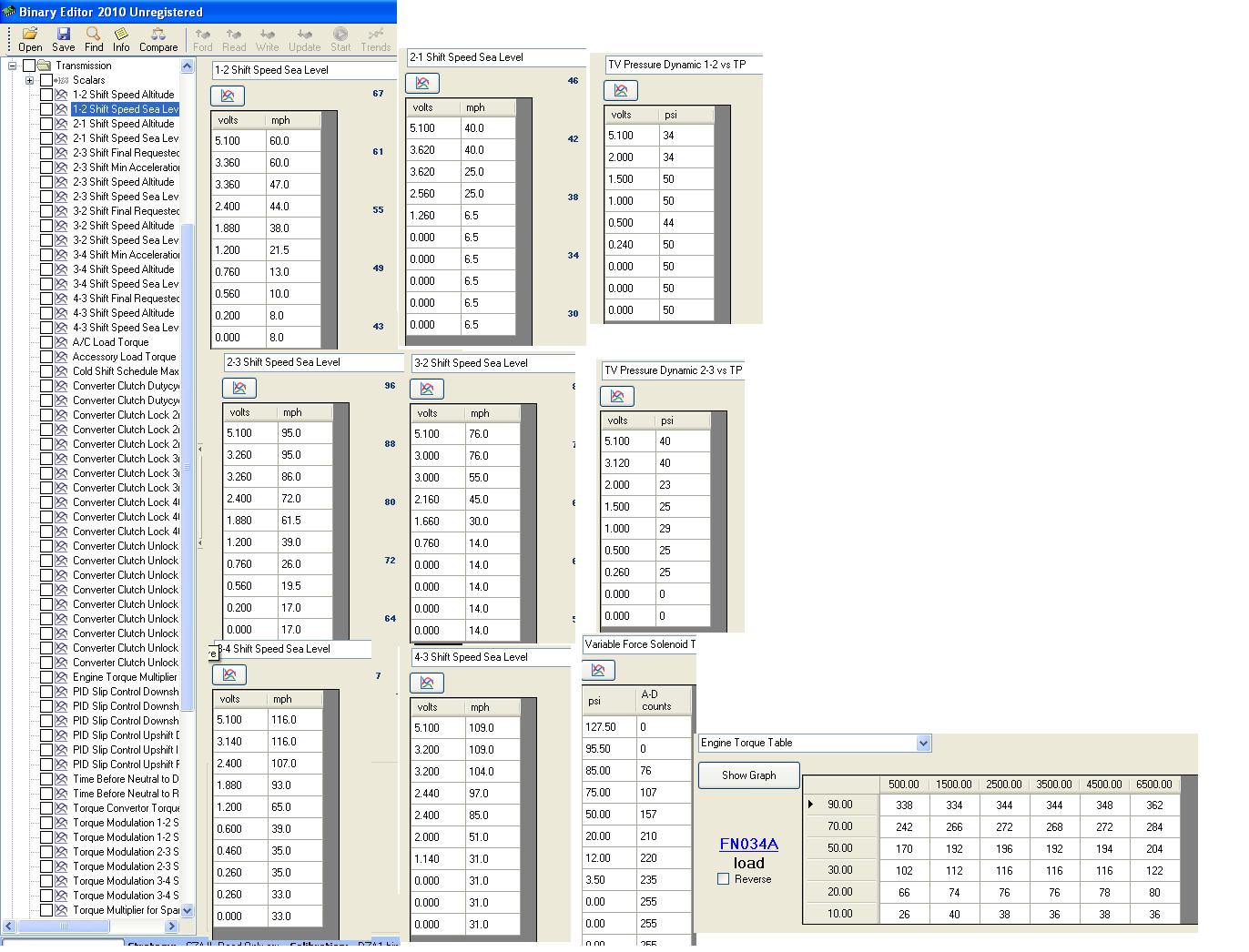

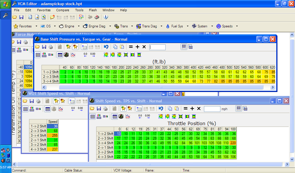

just for curiosity i have both ford and gm tuning software and will post a few pics

it is the concept of the kickdown cable used on virtually all 3 speed transmissions.
Ahford,
Yes, but only because they were conceived before electronic controls and TPS was the only measure of load that they had.
with map based shifting on a turbo an increase in map with a steady tps gives an unwanted downshift.
I would think that if the boost is rising the engine's output is rising and a more aggressive shift strategy is warranted. The code is designed so that you can avoid a shift by putting the appropriate values in the cells near that shift, of course. If you show us an specific example using a datalog and MSQ of a shift that isn't working using your shift table (and assuming you have your VSS issues worked out) we can try to see if there is a combination of bins, cells, smoothing, and hysteresis that will work for your setup.
That is a good reason for an electronically controlled blow-off valve (which can be done with the GPIO, and BTW I hope to add TPS to the MShift spare port conditions a some point as well), but I don't see how it is a good reason to change transmission control strategies.
Maybe, but that's a job for an electronic turbo controller, not a transmission controller. The trans controller cannot control the engine output (since it does not know what the torque will be after any given shift), it can only respond to it.
In an OEM application, where the engine's torque output at all speeds and throttle openings is a known, and with a drive-by-wire throttle in place, the TPS can act as a 'demand sensor', and the engine and drive-line strategies can be based on it. But where we don't have such a map of the engine's output, and we don't control the throttle position - we only measure it, the throttle position poorly reflects the engine output (both because of the engine rpm and any turbo boost lag/overshoot), the TPS isn't really delivering a lot of useful information.
Have you tried the new TPS/MAP percentage based function? You might find that 50%/50% or some other proportion delivers the transmission behavior that you want. The TPS part of the input would stabilize the load value, while the MAP factor would allow it to respond to boost to some degree.
