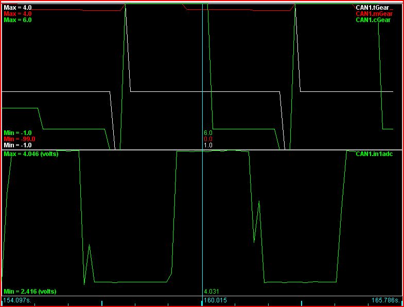

When I tested 5102tii I had no gear gauges on TS. I did a lot of testing over the weekend, I loaded 5102ti and changed Max. Lever Position parameter value from the current value of 1 to a value of 4 this time I noticed an improvement. At a medium/slow speed the faults quit and I took a log changing speed and positions P to 4, R to 4, P to N and as long as I went over 2 gear positions at a faster speed it faulted.The log showed no common elements
when current gear faulted to "6" but what ever you changed in 5102ti seemed to help!

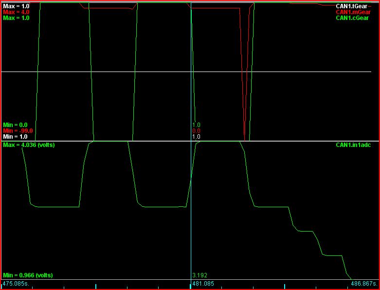

I didn't remember having this issue with 4146 so I loaded it and didn't have the 6 gear fault that i'm having with
5102. Not sure whats different but 5102 doesn't like my shift lever setup I'm using 4146 for now but the load doesn't work
as well as 5102!
I added 2 pics to show the difference, shifting from park to 4th and back to park.

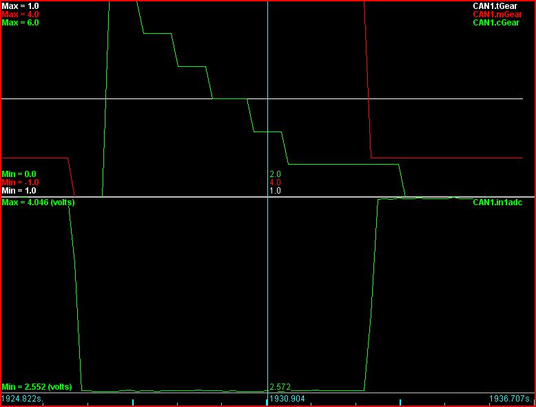

I loaded 5102vi entered only the lever parameters when I shifted no 6 gear fault but Need burn light came on cleared when cycled, back on when shifted. loaded rest of the parameters and 6 gear fault came back changed gears to 8 set (not used) gear values to 4.9 and got fault back except it cleared it self by stepping down 6-5-4-3-2-1 ( pic for this ) changed back to 4 gears and same problem as before interesting results though on 8.
I hope this feedback helps!

camomcharo,
Yes, this is very helpful. I will need to dig around in the code for a bit, but I will let you know when I have this fixed.
