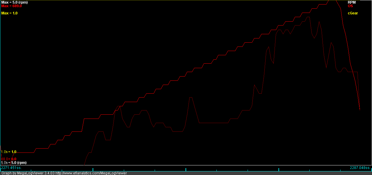

I didnt build up a new VR circuit but I had a Schmitt trigger made out of a 555IC.
I ran some sweeps comparing the OS signal in TS, as we see below there is a huge difference in liniarity
The sweep is 30sec going from 1hz to 500hz. The jumpy red line is the ISS circuit, the nice looking red line is by the Schmitt trigger
Same tune and filtering was used in both cases.
I did not solve the amplitude issue below 50hz.
Speedo can be stable at differnt amplitudes at low frequensis but as soon as I change the amplitude it starts jumping around agin...
Schmitt vs VR3.png (11.32 KiB) Viewed 22602 times
