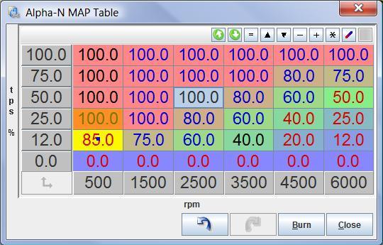

Ashford,
It occurred to me that we could use a table to get a better load measurement from the TPS signal, like MS-II does (see this: http://www.megamanual.com/mt29.htm#ra )
The problem with TPS is that the load for an given TPS depends highly on the RPM. For example, on my engine, 25% throttle at 2500 rpm gives all the power the engine has at that rpm (and 100 kPa manifold pressure). But at 6000 rpm, 25% throttle is only about 20% of the torque available, and 100% throttle is required to get full power (and 100 kPa). This is dictated by the facts that: the airflow depends on the engine speed as well as cylinder filling, and the throttle opening dictates the airflow BUT only up until the point where the cylinder is filled, and any wider opening does not affect power output at that rpm (until the rpm rises, of course).
If we use the throttle and engine speed as a look-up table for load, then we can set the the low rpm, high TPS cells all to 100% and more properly use the TPS to control both shifts and line pressure. Like this:
The table cells then represent the ratio of airflow at an given TPS and engine speed versus the maximum airflow possible at that engine speed; i.e. the table represents real physical quantities.
If users wanted to use the pure TPS signal only for their load, they could simply set all the values is a given row to the TPS bin value for that row. The the looked-up value would be the actual TPS, and RPM would not be a factor.
The other thing I am mulling over is an option to blend TPS and MAP in a user specified ratio (again, like MS-II) but I have to think though the ramifications of doing this, it is not as simple as it might seems (in part because we now have the option for different load indices on different tables).
Neither of these will necessarily help you (though I hope they might), but they ought to help some users.

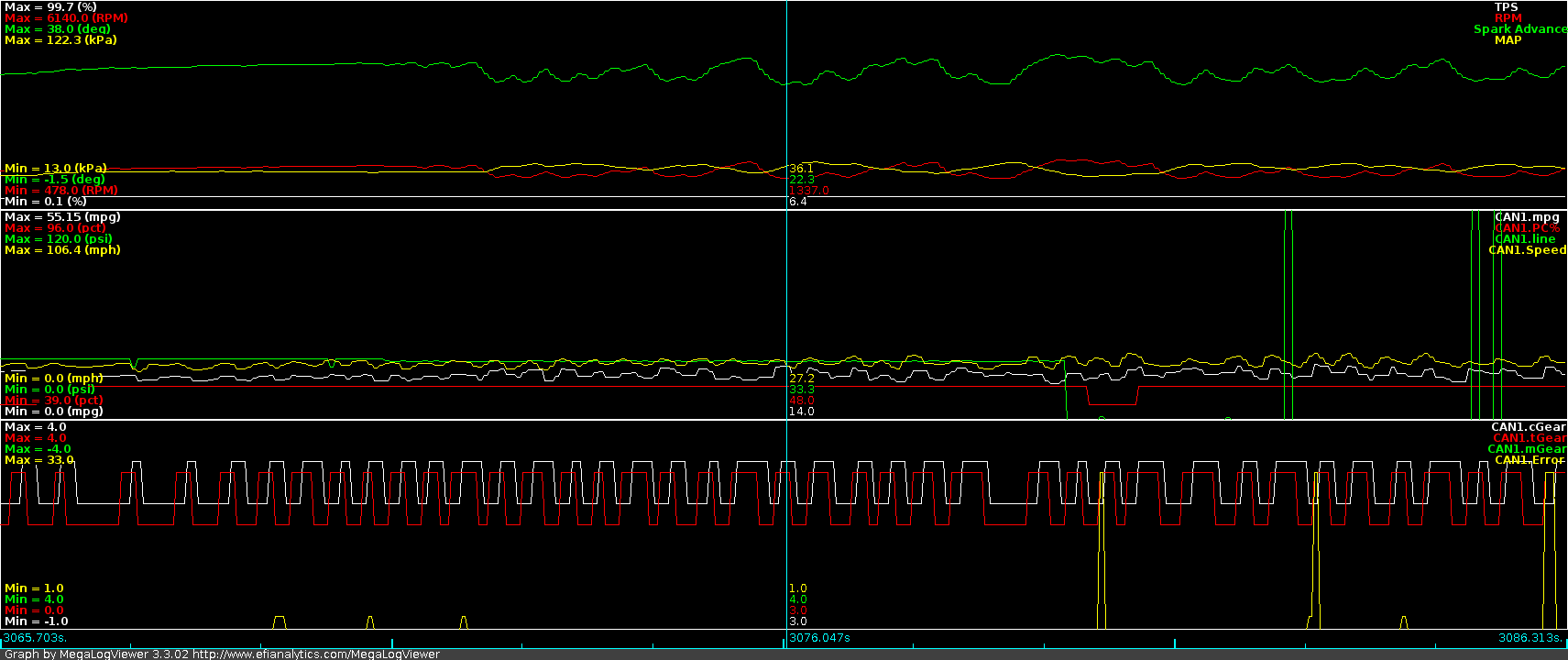

sounds like it is getting over complicated, the reverse idea i had is actually a simplificationremove the 16X9 and single point and replace with a 6 or so point graph. i have a turbo and 50% trhottle can make all different kinds of torque, what i am trying to avoid is the enevatable downshift of a map based table if i only want half of the engine power. eg i go to 50% throttle on the highway it will downshift to 3rd the turbo will then start to spool and build moderate boost, if this were map based it whould then downshift to 2nd- no i have the torque and i want to use it, if i want more power i give it more throttle to go to 2nd. basically the whole reason i asked for the tps based shift table with map based pc and i actually like it execpt for a few things i cant work out.
ok aside from the above rant im still sure something is wrong with hysterisis for 3rd gear a gradual approach to 3rd from 2nd or 4th resurlts in stutters if it is in 3rd gear aproaching 2nd or 4th everything is fine
i tried map based shifting again and went promply back to tps. i set in a large(40kpa) hysteresis, rescaled the loads and tried some testing around 60 mph i crept it up to 80kpa and it held then about 1 second after i let off it downshifted to 2nd :shock: . it show this twice in the logs.
its a busy weekend and week it is the nhra openers here ill try out the v2 code when i have a chance to see if it works. i did however do a 6.3@ 110mph today in the 1/8 mile with 100% humidity tomorrow the 1/4 mile should be open if the weather drys out.

Ashford,
Thanks for the logs, they helped pin-point the problem (when the hysteresis flag was set, the look-up gear was set to the currently selected gear (aka. 'current_gear'), but should have been set to the current 'target_gear'; because the shift was block, the current gear did not equal the target gear, and this cause an oscillation). This has been fixed in the 4.124 code here: http://www.msgpio.com/manuals/mshift/V4code.html That and the signature increment were the only changes for this code. The code is entirely untested, so use with great caution. I am reasonably confident this code will solve the hysteresis issue, but let me know if it doesn't and I will dig even deeper.
Ashford,
Looking at your log, I think this downshift is happening because you are very near a speed related 3/2 shift, but the load smoothing is keeping the load table high for a few seconds after you let off. You probably need to reduce your LOAD smoothing factor quite a bit from the 1000 it is now if you want to change that behavior. The load smoothing is intended to keep the engine/trans in 'full attack' mode even if you lift momentarily (like you might if you were racing on a road course).

tried the 4124 code took it for a drive and logged it, it was mostly highway so it was out of the problem area most of the time. i did notice 434343 stutter while decelerating, ii will take a look at it this evening when i get home

i took a closer look at my log th e 43434 stutter happens at 40mph on my lowest tps bin on the shift tablei have 3rd at 35 and 4th at 40. with a 5 mph hysteresis shouldnt a 4-3 shift happen at 30mph? or would it be at 35?
also when i took my logs i noticed it was doing gear shift way to early i took a look and my shift table had map values 20-100 instead of tps 0-100 it seems it didn't get impoted/converted corectly from the old msq, i changed these somewhere in the middle of the log.
