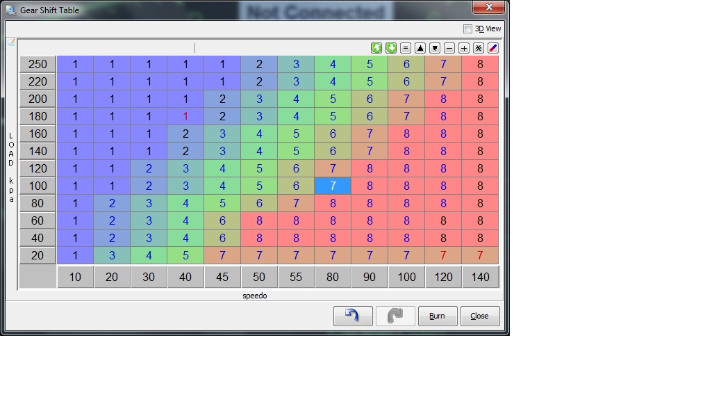

Re: subaru "5eat" also used in nissan g35 and titan
I have not installed the megashift yet, too busy.
but i recently thought of some thing and wanted your input on it.
most new auto trannys use the tcc in acceleration, it splits up the gears and makes it slightly more economical.
from what i understand the tcc control is only used in cruise fashion at the moment.
but to have more control than that would make it slightly complicated.
what i have just thought of is to make the 4L XX E trannys work as 7 speeds. where the tcc would actually be thought of as a gear solenoid instead. the gear shift maps and skip shift could be set that the tcc is used. ( could also have settings to have it inhibited when cold trans temp)
since the tcc is hydraulically unavaliable in 1st gear the shift pattern would be 7 speed
4T65e
1st = sol a on: sol b on; sol c (tcc) off
2nd= sol a on :sol b off: sol c off
3rd= sol a on: sol b off : sol c on ( same gear ratio of 2nd but torque converter slip gone)
4th=sol a off sol b off sol c off ( direct drive ratio )
5th= sol a off sol b off sol c on ( direct drive + tcc locked )
6th= sol a off sol b on sol c off ( overdrive speed)
7th= sol a off sol b on sol c on ( overdrive + tcc locked )
what this set up will expecially allow would be in manual mode you able to pull through the "7 speeds" as i have always done with my ratchet shifter and thrumb switch but make it in a way that the thumb switch is no longer needed.
the above is doable though current code of the megashift.for the gm 4 speed trannys but i am on the subaru 5 eat now
but due to the 5 shift solonoids + 1 tcc i cannot simply do this with out change in the code
the tranny would be a 8 speed because the tcc is unavaliable in 1st and 2nd ( part of limp home similar to the gm 4 speed trannys)
1st A OFF, B ON, C OFF, D ON, E ON, TCC OFF (1ST GEAR RATIO)
2ND A OFF, B OFF, C ON, D ON, E ON, TCC OFF (2ND GEAR RATIO)
3RD A OFF, B ON, C ON, D ON, E OFF, TCC OFF (3RD GEAR RATIO)
4TH A OFF, B ON, C ON, D ON, E OFF, TCC ON ( 3RD GEAR RATIO + TCC)
5TH A ON, B ON, C ON, D OFF, E OFF, TCC OFF ( 4TH GEAR RATIO)
6TH A ON, B ON, C ON, D OFF, E OFF, TCC ON ( 4TH GEAR + TCC)
7TH A ON, B ON, C OFF, D ON, E OFF, TCC OFF ( 5TH GEAR RATIO)
8TH A ON, B ON, C OFF, D ON, E OFF, TCC ON ( 5TH GEAR + TCC)
You might be able to do this using the 'Full Time Lock-Up' mode: http://www.msgpio.com/manuals/mshift/V2tune.html#nt
This lets you force a lock-up above a specified rpm (and gear). So if the load was above the TCC 'cruise mode' setting but the rpm below the 'full-time' mode setting, the trans would initial be in a specific gear, with TCC unlocked, then the TCC would lock-up once the specified rpm was reached.
This can also be done with the shift solenoids (the code allows for up to 6 shift solenoids), as you suggest.
