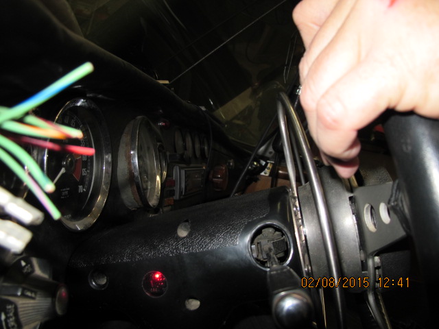

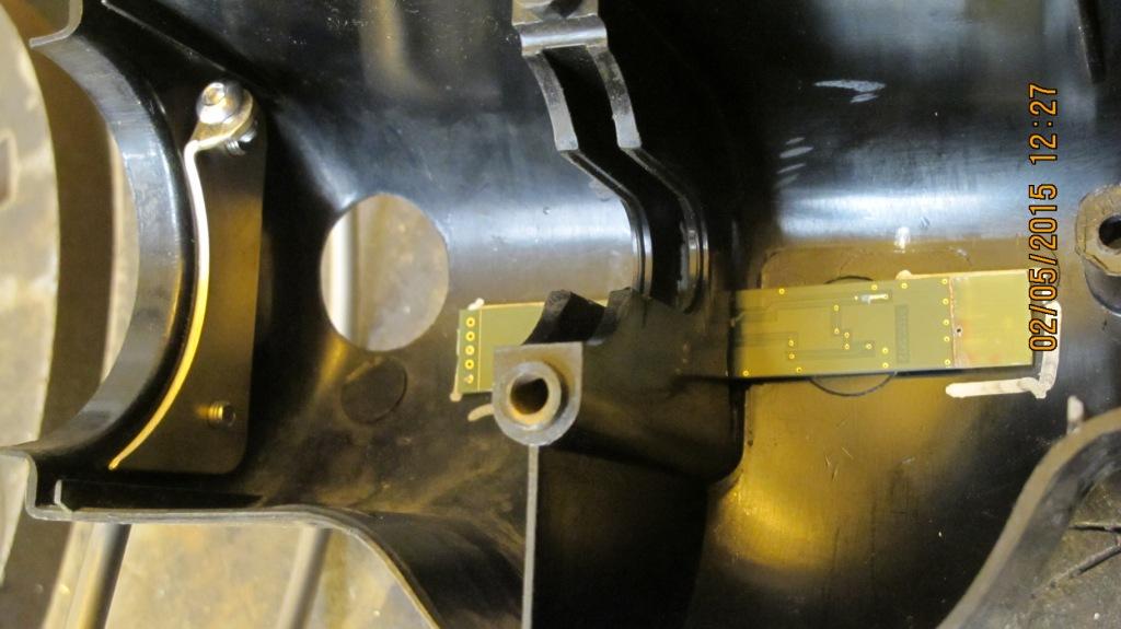

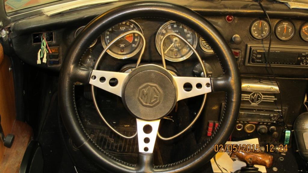

I am also using the NXP-Demo PCA8886 dual channel capacitive proximity sensor board connected to paddle shifters mounted to the steering column cowl. More about that later. AMP round body mini CPC connectors are on their way from Digi-Key to hook up those wires, leaving just the CAN bus, speedo and a couple of other wires to tidy up. Should be testing the jumper pins in a couple weeks if all goes well (still waiting on materials to finish the paddles).

Installed and tested.
Might have to scroll the bottom photo down to see the indicator light.
