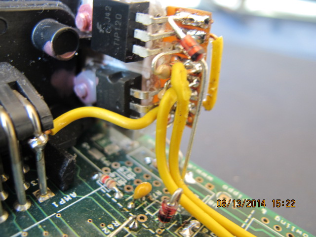

I moved the Shift Trigger solenoid SR to AD4/EGT2. Both EGT2 and AD0/EGT4 will need an off board TIP120 to provide a 12V+ output with a flyback diode to drive the two non-PWM solenoids. I think there might be room for them on one side of the Ampseal connector.

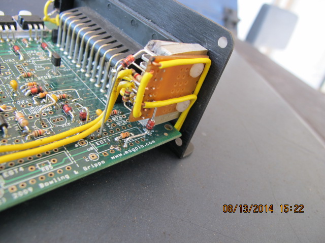

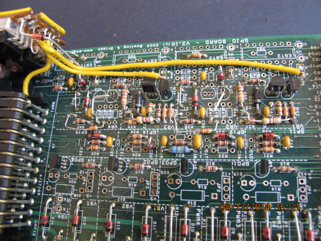

OK the board is now finished. On the pull-up resistors for the VR circuits I tied into the C(a) cap location as recommended in the GPIO build instructions. Otherwise all in accordance with the spreadsheet with the following variations:
Pull-up resistors for VR2 and VR4 were 330 ohm simply because I already had them installed on the board.
GPI3 is a 2.49K for the same reason.
Power for the two extra TIP120's came off the top side of AMP pin one as being more convenient.
I would also suggest maybe turning the PCB over if the same one is used as it would be easier to solder with the traces on the outside.
Ready for clean-up and a shot of lacquer to seal it and in the box it goes. A little sooner than I expected. Next, the wiring harness. I got Matt to sell me long wires in rainbow colors so I will probably add the wire colors I assign to the spreadsheet.
