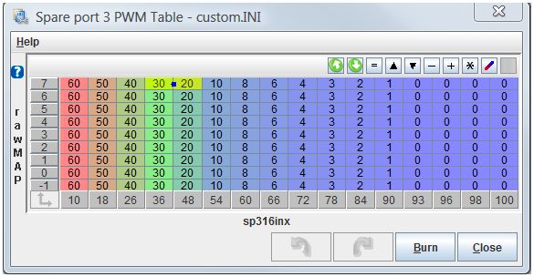

That's odd, because I tried it here before I posted it and it works fine. I get no errors at all, and I see this for the sp3 PWM table:
That's with TS 2.6.18 (Lite).
