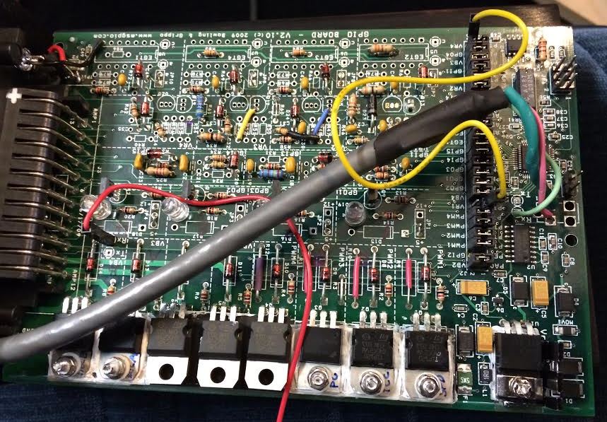

My 4L80E has a TransGo HD2 kit installed with higher pressure reg spring, so it runs from ~125psi to 200psi with my current PC% settings.
My current setup is:
-A Serial shielded cable 24" long soldered directly to board where DB9 would be (shield grounded at board)
-Serial to USB adapter 30" long
-Comm port "4" used on laptop
-Windows 7
Is there a way to "see" what noise is on the serial line.
I have an old oscilloscope that I could probe around with, but not sure where to start looking?
Rob
DIY'er with Your help :-)

Just to be clear, are you connecting to the serial connection on the GPIO board (or on the engine's controller)?

Yes, I'm attached directly to the GPIO board where the DB9 connector would normally go (see attached pic of my GPIO).
I will try to create a "Debug comm log" and share soon.
Also attached is my latest Project file.
