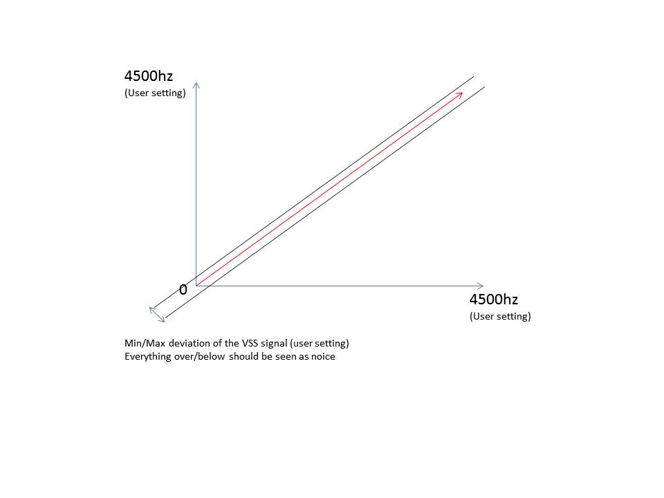

In my head the logic tells me that there is only a certain speed increase over time that should be seen as valid speed so not sure how it or if it could be done or if my logic is that logic :-)
Now in theory this will not filter anything since X and Y will see same signal and noice
This could be worked around if X and Y have different sampling rates so they never look at
the signal at the exact same time, this might however not be possible to do within the code?

It's certainly possible to set a limit in the code on the rate of change of the speed (i..e the first derivative of the VSS period). In fact, that's essentially what the input mask is, but the accel/decel would be averaged over a longer period instead of over a few dozen teeth.
I suspect that:
- the limit on the rate of accel and decel will need to be different (most cars can brake significantly faster than they can accelerate, and they ones that can't are scary to drive!),
- the rate should probably be speed dependent, i.e. most vehicles car accelerate much faster at low speed than high speeds (because of gearing and aero effects). This is sort of like the speed-dependent filtering you mentioned earlier, I suppose.
The question becomes, what do we do if the accel is outside that range. We could:
- limit the rate of change to the max (on the assumption that some, but not all, of the signals are false),
- limit the rate of change to zero (on the assumption that the signal are entirely false),
Then we would need to decide if the limit applies only to the speed calculation, or is also applied to the raw VSS input filtering (which can cause all sorts of troubles).
BTW, the code once had such a scheme (which was applied to the VSS filtering rather than the speedo calcs), and while it worked for some, it was a nightmare for others. So this would need to be implemented carefully.
If this gets implemented, it will be in the 5.00x series of beta code.

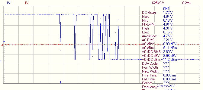

Found this at a closer look of the signal at VR1 at the 25pin header, 50hz sine wave out from the signal generator and ppv 8v
I guess that the processor doesnt like this, speedo in TS showing max speed....
So it seems to be hardware after all...

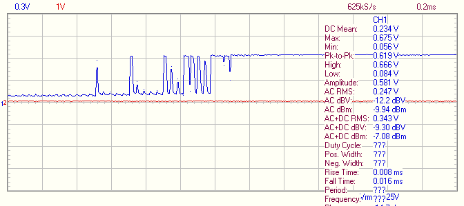

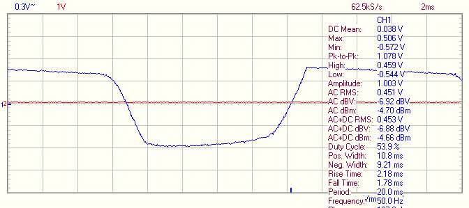

Some more scope shots.

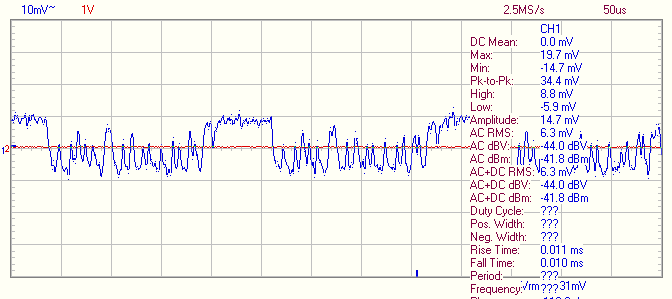

Noice in the 5v supply (internal GPIO)
5v supply.png (11.15 KiB) Viewed 21691 times
signal at R43 at 50hz
50hz at R43.png (9 KiB) Viewed 21691 times
Signal at R45 at 50hz
50hz at R45.png (9.4 KiB) Viewed 21691 times
Well spotted! I strongly suspect those oscillations are the source of the problem. The most interesting place to scope would be the base of Q13 (the transistor's middle pin), as this is the intermediate stage in turning the AC signal intro a square wave. (Nevermind, that's what your R43 shot is showing)
For the power supply, if the divisions on the blue trace are 10mV, then the variation (34mV peak-peak, 6.3mV RMS) is fine. It's a bit hard to tell though, since the absolute level isn't specified (it looks like the screen shot has AC settings displayed).

I actually just stumbled over this, if I masure the VR1 signal at the 25 pin header and just hit the auto scale function on the scope it will display a perfect square wave.
What I noticed was that I didnt get any frequency reading in the wave form parameters, thats when I changed the time line to strech out the wave....
Actually the raising edge is looking the same as the falling.
As usual I forget to switch over to DC as I did checking the 5v supply.
