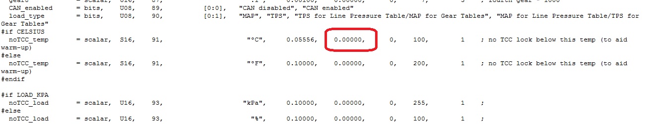

As for the TTC lock temperature issue I have found it, the problem was on the INI file
I have edited the INI for the no hyst below speed maximum and conducted a search for 5556 and have found the translate bin = 0.00000, I have set it to 32.0000 for my next datalog ride.
Sans titre.jpg (82.79 KiB) Viewed 23941 times
