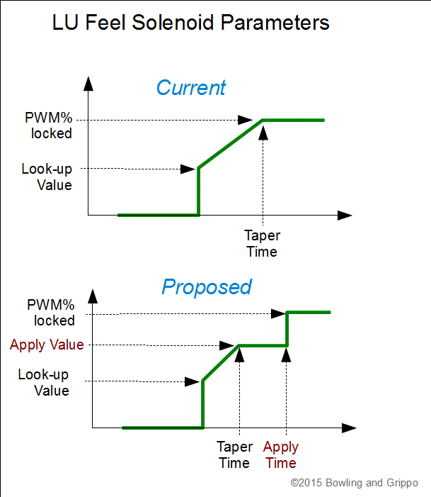

I know very little about the LUF solenoid and how it ought to be controlled. Everything I have found is already in the manual. The info you have posted, is that for the TCC solenoid or the LUF solenoid (is that what they are calling the TCC PWM valve)? It looks like it ramps from 25% to 50% PWM, then holds for a similar period, then goes to 100%. The code doesn't do this right now, but could be made to mimic this behavior. We would need to have a running, installed transmission and a willing tester before any code can be tested, of course.
Re: Advice on Lockup Feel solenoid for 4L65e
Just to flesh this out a little more, what I propose is to add two new parameters to the LUF control:
- apply time and
- apply value
The current code allows the PWM% to vary from a user set value (via an interpolated value based on two points) to the fully locked value (normally 100%) over a period the user specifies ("PWM Taper Time").
Added to this, the apply value would set an fixed limit on the PWM% after the taper time, and would hold this value until the user set 'apply time' has elapsed.
I think this is what would most closely match what I have read in the documents.

I understand that PWM and ramping it up is currently applied to the "TCC solenoid" output. This was done to achieve a smooth TCC lockup IN THE ABSENCE of the LUF.
Now with a LUF, the "TCC solenoid" will simply get a hard on/off (ie no PWM) and PWM will only be applied to the LUF output as per your proposed regime? If so, it looks good to me.
