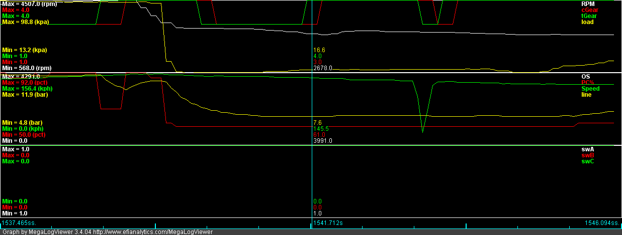

Made some WOT pulls on 3rd gear and when I let go of the throttle it shifts up to 4rth as expected but then it shifts straight back to 3rd and then back to 4rth...
Not so nice doing 150kph....
Attached msq , log file too large.

Are we talking about the incident at approx. 1538 to 1543 seconds in the log?
There is a 3-4 shift (1538.3 sec): speed = 150, load = 98.8 - this shift is caused by moving horizontally across the top row of the shift table, as we have crossed the boundary from 3rd to 4th.
Then there is a 4-3 shift (1540.2 sec): speed = 148.7, load = 13.3 - the throttle has been backed way off (8%), and the speed has dropped. Thought the speed is below 150 again, the reduction in load should push the target gear to a much lower part of the table, and the target gear should still be 4th. So there should be no shift, at first glance. But the load is averaged over time in the code, and the controller is likely still responding to the higher average rather than the current value, so you get the shift. So you might reduce the averaging, by reducing the LOAD Smoothing Factor. You can read about this here: http://www.msgpio.com/manuals/mshift/V41tune.html#gs (this also reminds me that I should add the averaged load to the datalog).
However, I think there may be another clue to why this happens at 1504.754 seconds in the log, where the speed drops to 27 in the log. I think this is may also be happening prior to some of the other unexpected downshifts, but the log is too slow to capture it most of the time. So I will have a look in the code. In the meantime you could try:
- increasing the VSS input masking factor,
- increasing the VSS smoothing factor,
- reducing the max. vehicle speed setting,
- increasing the minimum speed,
These are all described here: http://www.msgpio.com/manuals/mshift/V41tune.html#gv
Some combination of the above should help significantly.
Re: Unexpected down shift
I see that the averaged LOAD *is* in the log, it is called "sLoad" (sorry for implying that it wasn't - I didn't see it at first glance).
If you look at it at the point the unwanted downshift occurs, sLoad is at 96.5, which is still the top row of the shift table, and this is why the downshift occurs. sLoad starts dropping soon after that, but too late to prevent the downshift.
So, as I hinted above, you may want to reduce the Load Smoothing factor (maybe by quite a bit!). This will make the sLoad follow the actual instantaneous load more closely, and make the trans more responsive (but if you go to far the target gear might jump all over the gear table, so use some caution).

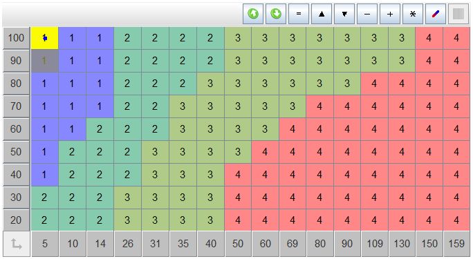

Second thing, if the "dot" we see in the gear shift table is Load wouldnt it be better to actually have sLoad as indicator? Then we can see directly what the lag factor is doing at the same time.
Second thing, if the "dot" we see in the gear shift table is Load wouldn't it be better to actually have sLoad as indicator? Then we can see directly what the lag factor is doing at the same time.
Yes, of course. It was an oversight on my part not to do this a long time ago. I will attach an INI with this change for the current 4.146 test code (from another recent thread), but you (or anyone) can change any earlier INI by using a text editor and finding a line like this near line 2553:
yBins       = LOAD_table1, LOAD, readonly
and change LOAD to LOAD_short, like this:
yBins       = LOAD_table1, LOAD_short, readonly
Save the file, and then you can load it in TS. You also might need to do gear table 2, near line 2563.
