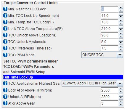

Don't confuse the TCC functions. There are two mostly independent TCC strategies:
- full time lock up is intended to lock the TCC at high speeds/rpms/loads to get a few more mph in absolute top speed. Full time TCC parameters are not intended for controlling the TCC in all situations. The full time TCC settngs are the bottom four parameters in the menu below.
- the regular settings (the top 8 parameters) are intended to lock the TCC at low speeds, loads, rpms ans higher trans temperatures (and unlock it at cold temperatures to allow the trans to warm up more quickly). This is the 'normal' control' strategy for a TCC, and based on what you have said I believe this is where you ought to concentrate your tuning effort.
