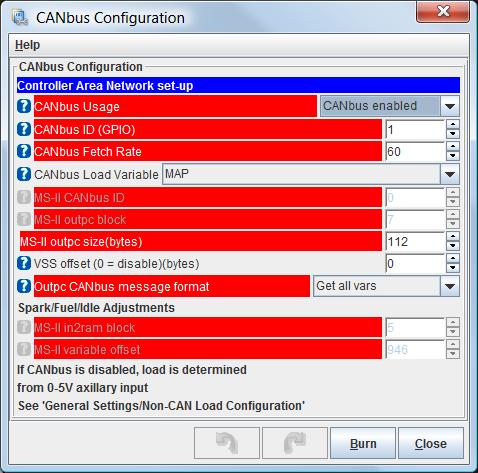

Can you see "Tools' on the main menu in TunerStudio? If you can't see that, it may have scrolled off the screen if the ECU menu is very wide, and then you need to adjust the size, or you may need to change some appearance options in TunerStudio. Once you can see the Tools menu item, click on Tools.
A menu will drop down. One of the items will be 'CAN Configuration'. Click on that. A dialogue will open, and the fourth parameter down will be"CANbus Load Variable'.
You will have four options: "MAP", "TPS", "TPS for Line Pressure Table/MAP for Gear Tables", "MAP for Line Pressure Table/TPS for Gear Tables". Click on TPS if that is what you prefer. The MShift code will then use TPS instead of MAP for LOAD in all calculations. 'Burn' the value (click the Burn button) to save it to the controller. You might want to save an MSQ at this time to.

thank for reply...ok i was not clicking on my contoller to open the options menu (2nd pic)..dooh..!
