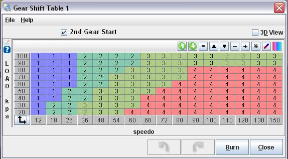

Does MSShift have the capability to do 2nd Gear Start like some OEM systems do? What this does is command 2nd gear if the shifter is in M2, regardless of VSS.
I know it could be done with the 2nd shift table, but I already have plans for that (Race vs Street trims). During a burnout in the water box, it would be handy to have the trans start in 2nd. It just avoids an unnecessary 1-2 shift in the water box.
I was thinking a check box could be added in each shift table window like this:
gear table.jpg (43.46 KiB) Viewed 27531 times

The code can be shifted manually into 2nd gear and it should stay there. You would then have to switch to auto mode if you wanted to use the tables for shifting.
However, there is no separate second gear start function apart from the tables or shifting manually. It could be added easily enough, though, and I will look at this for future code once the current tissues are worked out. The best plan is probably to use an input that signals that the next start should be in second gear (or perhaps a user-specified gear if the gear lever is in a specified position and the speed is zero).
