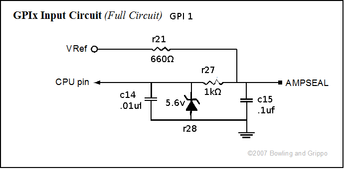

building my gear position lever circuit this is what i come up with
from repari manual
park 3770-4607 ohm 3.97-4.85v
rev 1304-1594ohm 3.24-3.96v
net 660-807ohm 2.55-3.11v
OD 361-442ohm 1.88-2.3v
2 190-232ohm 1.25-1.51v
1 78-95ohm .61-.75v
the dead center of voltages comes around 600-660ohm so would this do?
Re: 4r70w setup
ashford,
Assuming the shifter needs a 5V pull-up and this is supplied from the controller, then that looks reasonable to me at first glance.
There is more here: http://www.msgpio.com/manuals/mshift/voltlever.html (Rs on that page would be r21 in your diagram).
