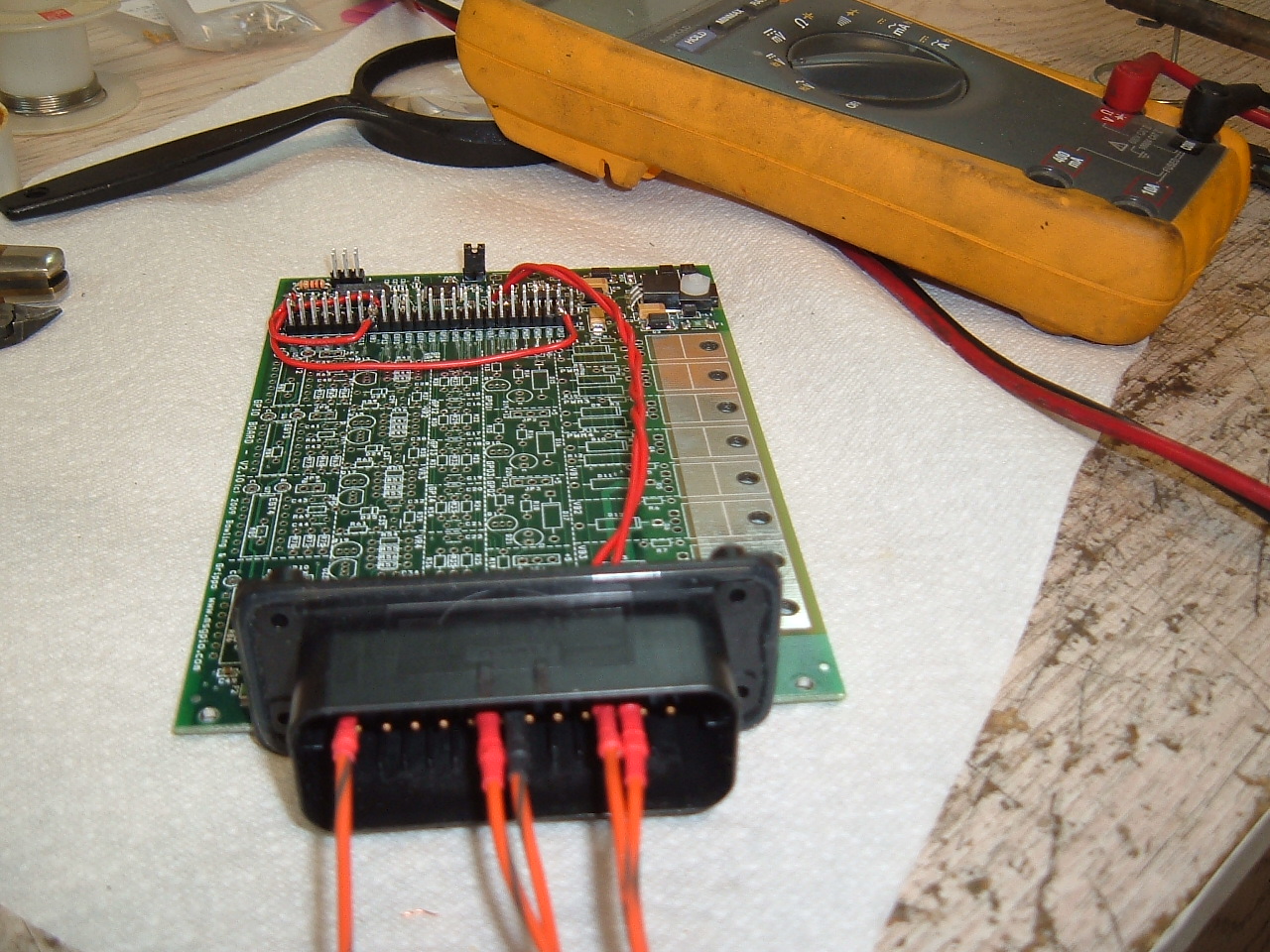

Just bought a GPIO with 4L60E package from DIY Autotune along with the stim, but assembling the board early on I come to this instruct where it wants me to power up the board but there's no mention of how to power it up?
So this thing is laying on my bench and I see the part about hooking up the serial cable, apparently there's 3 wires, I see the spot on the board to hook up Tx and Rx but where does the ground go?
So if I plug in some of the supplied ampseal wires directly into the connector plug I soldered to the board can I run 12V pos and neg to some of those, install the 2 Rx and Tx jumpers and the serial data ground will just get handled somehow?
I think I have the LM-1 serial cable with the stereo jack somewhere, does it help somehow?

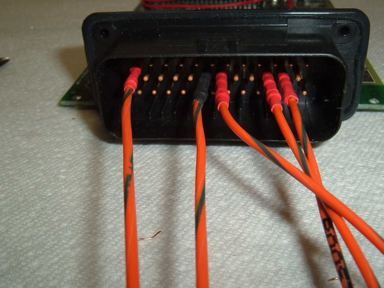

I noodled it out along the lines you posted. I have the two long jumpers from Tx/Rx to Tx/Rx on the board. I have the jumper on. I'm using a standard car battery, about 12.5 V. I bought from DIY Autotune, no stereo jack. I made a serial cable from a piece of CAT5 using the DB9 connector. I used the AMP pigtail wires for the other end. I used other AMP pigtail wires to make 12V power and ground. I have 12V between 1 and 17,18,19,20. I have 5V at the two leads on the 5V regulator furthest from the edge of the board. I have a USB/Serial dongle attached to an older Dell laptop. In the pic the two on the right are Tx/Rx on 21 and 22, in the middle are the 12V and serial grounds, on the left the 12V pos. I switched the grounds between 17 and 18, no good. I switched 21 and 22, no help. No comms.
loader comes up OK, finds the S19 file, reads it OK. Then I get messages about opening COM4 (correct) at 19,200 (correct), them wake up attempts 9-5, reopen COM 4, wake up attempts 4-0, then ERROR timed out 0xE0. I did turn up the log level to see that 0XE0. settings on the dongle are 19200, 8,N,1, no flow control. tried various flow control, 9600, checked setting same for dongle and loader program.
Unless you have insight into the wake up attempts and 0XE0 I'm going to figure this new Serial/USB dongle is bad. I don't think it's ever getting to the processor.

another pic showing the relevant parts:
Re: Is this the MSGPIO support forum?
tmoble,
The serial port should be 115200, not 19200. But that may not be your problem. Unfortunately, a few GPIOs have managed to escape the factory in the last month without proper bootloaders on them due to flaky BDM hardware. This can easily be put on properly by someone with a BDM cable.
If you got this from DIYautotune, please contact them, Matt will know what to do. If you got it somewhere else, PM me and I can tell you what you should do next. Sorry for the hassle.
