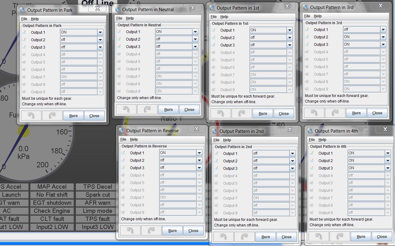

Also, not sure what the spare port functions should be set at - I'm not using any as far as I know?
Aaand - when you set the 4L80E as the transmission type it sets the output solenoids as the attached photo. This is different to the picture at the bottom of this page, though as 'Output 3' isnt used with the 4L80E I expect it doesn't matter?
http://www.msgpio.com/manuals/mshift/4L80E/4L80e.html
output solenoids.JPG (218.85 KiB) Viewed 42198 times
