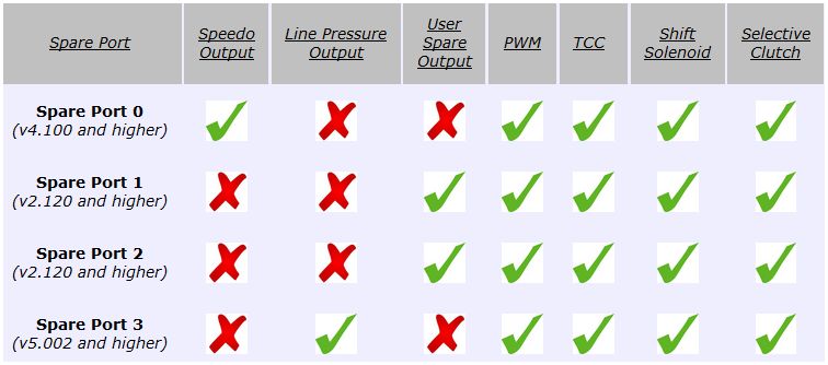

"Spare port" is a general term we use to mean that an output (and soon some inputs) have functions in addition to their original use. When the output is used for it's original purpose, it is just called by that name. However, when it's function is changed by the user, it becomes a "spare port". A spare port can usually be configured as a shift solenoid output, in which case it becomes OUTPUTx as well as a spare port (ex. spare port 2 becomes OUTPUT4 aka. OUT4 when it is configured as a shift solenoid output).
For example, processor pin PT4 is the speedo output unless the user decides to configure it as a spare port (sp0). If the user chooses to do that, then the user can choose whether to use it as a clutch output, shift solenoid output, or TCC output (with user configurable PWM). Each of the spare ports has these option, plus there original (default) function, and possibly what is called the 'user spare port' (on sp1 and sp2) that lets the user set the conditions in which the port is ON or OFF (as well as the PWM settings). PT4 is normally connected to PWM1 (and Amp31), but the user can swap this on the 25x2 header (and typically would *have* to swap it if the original connection was to an input circuit, such as with spare port 4 and spare port 5).
Originally, spare port 1 and 2 were implemented because these outputs had no assigned functions for the original target 4L60e, so they were made as flexible as possible for users to set when they would be on or off (i.e. "user spare ports"). More functions were added to these spare ports over time (selective clutch, TCC, and shift solenoid). Other spare ports (0, 3, and soon 4 and 5) were added because some users didn't need all of the default assignments, but they need more outputs for their application.
Spare ports 0 through 3 are described here: http://www.msgpio.com/manuals/mshift/spareport.html
The original functions are in the second and third columns (speedo output and line pressure output), the "spare port functions" are in the last 5 columns.
The web page linked by Thor_patrol also gives the original function as well as the associated spare port[0:3].

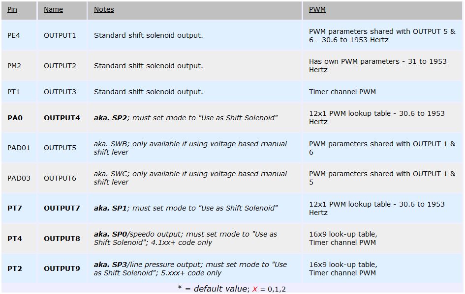

These are the assignments:

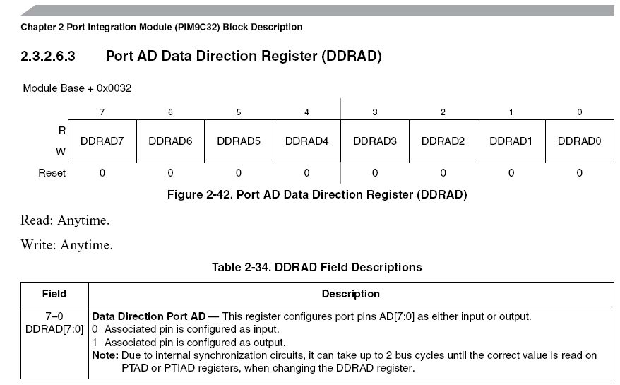

You may wonder why PAD01 (Output 5) and PAD03 (Output 6) can be used as outputs, when I said in another of your threads that, "PAD04 (line pressure sensor input) can be used as either an analog-to-digital (ATD) input or a digital input. It cannot be used as an output, unfortunately (it is not a general purpose input/output port)." I certainly wondered about that!
It turns out that the freescale docs are contradictory on this point. Some sources say that the pins can be ADC or digital input only, while others say they can be configured as outputs using the data direction register (DDRAD) - it can be used to configure the ADC pins as inputs OR outputs.
This is on page 102 of the document MC9S12C128V1.pdf
I am sure we would have tested output5 and output6 before releasing code with these enabled. However, I will re-test these to make doubly sure.
In assigning the outputs, you have to decide how the PWM works best for you. Some outputs are more flexible than others (single PWM%, 1x12 table or 16x9 table), and some share things like PWM frequencies. So you might have to juggle them around to find the best configuration for your trans.
The code output's numbers (OUTPUTx) are fixed with respect to the pin and spare port. So spare port 4 is*always* on PT6, as is output10. They cannot be moved around (though the output circuit (PWMx, etc.) can be assigned to a given processor pin with a jumper on the 25x2 header).
Processor pin PT3 is the TCC output. It is not a spare port, it has only the TCC function. So you would use it for that (added functionality can be written into the code, of course).
Processor pin PT6 is the default paddle upshift input, and has been assigned for spare port 4/output10 use in 5.202+ code versions (in which case PAD04 becomes the paddle up input).
Processor pin PE1 is the default table switching input, and has been assigned for spare port 5/output11 use in 5.202+ code versions (in which case PE0 become the table switch input).
