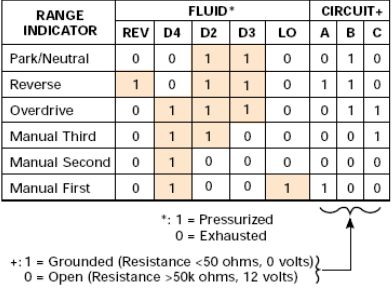

Re: 4L80E code
Guillaume,
I think you may have the inputs inverted. I believe the trans should show second gear (D2) as HIGH-HIGH-HIGH when there's no pressure to close the normally open switches (a closed switch grounds the supply, so the signal is low).
The chart is a bit confusing, because it shows 0 for 12V, and 1 for ground.

The 4L60 and 4L80 have the same input pattern and the HIGH &LOW it was a little confusing at first but Lance has the correct settings in the 4L80E wirring page. the only thing that will change is SOL B for the output.
FYI if you didn't already know your Input VSS teeth count is 31, I don't have a MSQ that I would release right now as I have not tested it in my ride to verify it.
