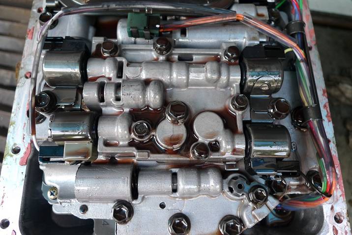

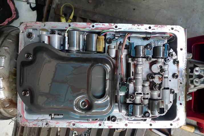

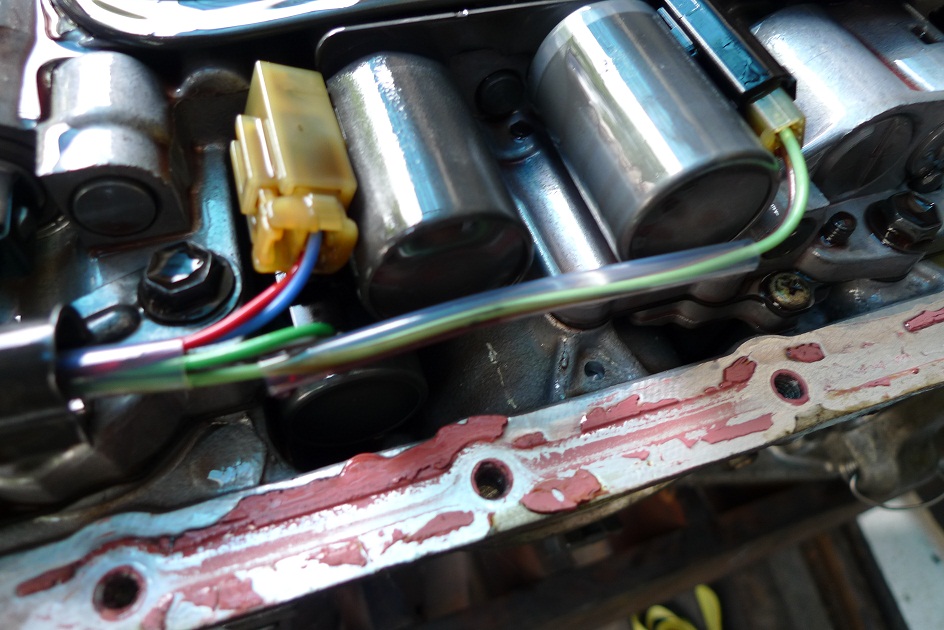

Hi All,
Can anyone help understand how the shift solenoids on this transmission work? At first I thought this is a a650e, but this is still a a340e 4speed auto with 7 solenoids. It came from 1JZGTE VVti engine. My plan is to install MS3+MS3x for the engine and MSgpio for the auto.
I tried Looking for JZS161 or JZS 171 FSM with no result. So I really hope you guys can help me here. Thanks Guys.
Regards,
Doddy
Valve Body
Valve Body
Valve Body.jpg (62.94 KiB) Viewed 84288 times
TCC Shift Control and Lock Up Solenoids
TCC Shift Control and Lock Up Solenoids.jpg (199.8 KiB) Viewed 84288 times
Shift Solenoids
Shift Solenoids
Shift solenoids.jpg (60.65 KiB) Viewed 84288 times
Re: AA80E 8-speed
Have you looked at the AA80E files? With a difference of 2 solenoids I suspect the operation is pretty similar. Also, I do have a file on the A650E that I ran across a couple days ago which might help if you don't have it, but it is on my other laptop. It's Toyota's description from their training manual.
Jim Nichols over on the BritishV8 forum is using an A340e though I'm not sure of the version. He might be some help though.
Ah, here we go, I just did a google search for A340E training manual and came up with this file. It is too big to upload. Should be most of what you are looking for.
http://www.japanerfusk.dk/Auto%20A340e%202JZ-GE.pdf

Thanks Jim,
The documents you gave me only have two shift solenoids and 1 lock up solenoid. Mine have 4 shift solenoids and 1 lock up, 1 clutch solenoid and 1 line presure solenoid and still 4 speed. This is confirmed by www.toyodiy.com under toyota crown athelete 2002 1jzgte engine. Seems lady luck is also not on my side too. Hahaha.
