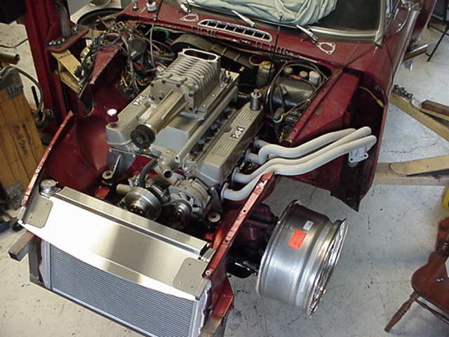

Update: Getting closer. I now have the wheels and rear tires (over 2K) and am coating the headers with Techline Cermachrome. Major tasks still preceding tranny control include the air scoop/throttle body, driveshaft, shifter, and new lift mechanism for the tilt front end, plus condensers for the intercooler and A/C, installation of an A/C compressor and completion of the drive belt system. My timeline has these preliminaries completed by the first of the year, then I can return to the tranny controller in ernest.

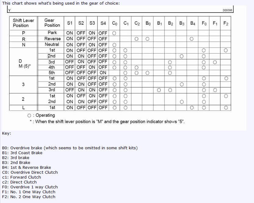

How goes the A650E development? I want to get a GPIO board to test on this platform but want to avoid "re-inventing the wheel" where-ever possible.
To contribute, I have both the flow chart (not verified) and control schematic PDF to attach. I am trying to get up to speed on the GPIO as best as possible. If it can control 4 solenoids, and three PWM solenoids, I can't see how this wouldn't work. As mentioned in other threads, the GPIO would not work by grounding a + signal from the tranny, but must send out a + signal (grounded at the tranny). But thats a physical layout alteration, the hard part for me is finding documentation on 4 solenoid and 3 PWM solenoid control (1-4 solenoids, its a 5 speed, one PWM is for line pressure, another for TC lockup, the third I'm still trying to figure out).
A650e flow chart.PNG (170.43 KiB) Viewed 130261 times

Token wrote:How goes the A650E development? I want to get a GPIO board to test on this platform but want to avoid "re-inventing the wheel" where-ever possible.
A650E will work. Before using the A340E I'm currently running, I was using some weird A343E with an A650E valve body. You have to add P-Channel MOSFETs to the shift solenoid outputs since they are high side switching. The other solenoid in question is accumulator backfill. The higher the current supplied, the softer the shift "feel". I probed a stock car and found that it sits at about 20% duty cycle until a shift is performed, then the backfill solenoid current is brought up to the desired shift feel.

Did you use 2.111 or the beta 4.006, or did you have to customize the code? Looks like you setup the 1-3 solenoids per write-ups, and then also the spare optional 4th solenoid setup for #4, TCC is another separate component provided for, and pressure control yet another already provided for feature, and then you used one of the MS3x PWM generic outputs for the last component left, the accumulator backfill?
I was hoping to make the GPIO a standalone controller, but still excited to see full tranny control possible with a combo.

Another question would be the shifter input. The A650e in the attached PDF has one input for each selection going to the OE ECU, making for a total of 8 inputs (P, R, N, D, 3, 2, L, M). The Mega-shift only has 4 inputs. P and N can share one, D its own, R its own and I suppose 3 its own. M doesn't need to be tapped, the software engages M without the need of an external switch, I suppose some well placed diodes can give 2 and L the ability to be input?

Token wrote:Did you use 2.111 or the beta 4.006, or did you have to customize the code? Looks like you setup the 1-3 solenoids per write-ups, and then also the spare optional 4th solenoid setup for #4, TCC is another separate component provided for, and pressure control yet another already provided for feature, and then you used one of the MS3x PWM generic outputs for the last component left, the accumulator backfill?
Using 2.111 as it was downloaded from this site, no modifications. I am currently using MS3X for accumulator backfill. If you want full standalone then you can run without accumulator backfill, but your shifts will be noticeably firm. You can back down the line pressure a bit in the lower load bins to soften up the shifts, but it gets to a point where the trans just slips into gear. Honestly if I had to live without accumulator backfill it would not bother me a bit. Perhaps I could start a thread to determine the possibility of having a general PWM output for such functions. It would be nice to have all of the trans functions on GPIO, I agree.
Token wrote:Another question would be the shifter input. The A650e in the attached PDF has one input for each selection going to the OE ECU, making for a total of 8 inputs (P, R, N, D, 3, 2, L, M). The Mega-shift only has 4 inputs. P and N can share one, D its own, R its own and I suppose 3 its own. M doesn't need to be tapped, the software engages M without the need of an external switch, I suppose some well placed diodes can give 2 and L the ability to be input?
Yeah, you can split some signals out so they pull multiple inputs low. With 4 inputs you can have 16 logical shifter positions, so you're OK with 8 positions. I went simple on my trans; P N and R all share the same input, D 2 L have their own inputs.
