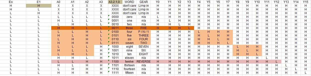

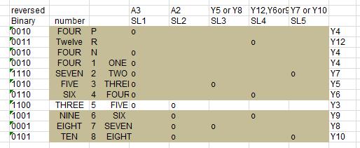

If i use 4 LED drivers or four solenoid drivers, and if i can generate 16 unique binary numbers with those 4 lines, I can demultiplex the data and have 16 unique commands numbered 0-15.
So, I sat down with the shift strategy for the solenoids and a truth table for 4-16 demultiplex chip and for the princely sum of approximately 'lunch-money' I may have a work around.
The 4-16 demultiplexer chip uses 4 inputs numbered A0-A3 and outputs a single 'low' on one of the outputs Y0-Y15

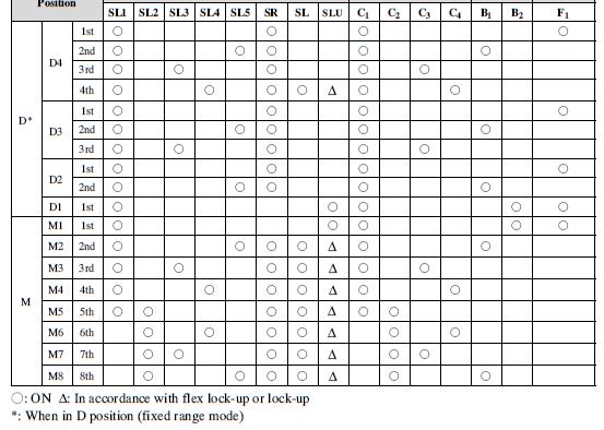

SL1 and SL2 are in almost all of the shift patterns and in fifth, they are both used. I applied A3 to SL1 and A2 to SL2. I can then use a 3 input OR gate to develop the logic for SL3, SL4, and SL5 with the demultiplexed triggers.
I then select an option for A1 without A2 or A3 activated ( to ignore S1 and S2 ) and use an OR gate to Grab SL4 for the unique Reverse requirement.
So my thoughts are 74HC154 ( now obsolete in a DIP package) and a 74HC/HCT4075 Triple 3-input OR gate and driver transistors on the outputs.
attached are a couple of images so you can have a look at the logic.

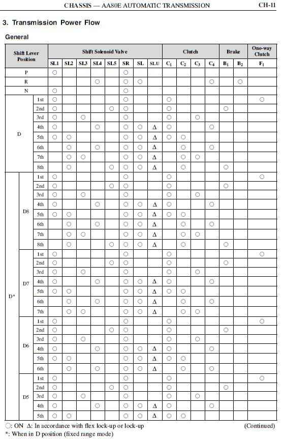

It wouldn't let me attach a fourth file so i'll put the transmission tables here.
The beauty of this Jekyl and Hyde pseudo-multiplexed system is it should give us access to the 10 speed transmissions without further major revision. I have a few lines left in the tables above.

John, this is pretty interesting and I will look it over more closely over the weekend. On first look the one thing I would mention is, do not overlook the shift trigger solenoid. I think it is SLT. The transmission will not come out of Limp mode without it. As I understand it, SLT is a PWM solenoid which apparently pulses to trigger a shift event. If the PWM signal is not present the transmission will default to limp. The description indicates that if the solenoid is fully closed or fully open limp mode will occur. Hydraulically this would mean that some leakage is required for normal operation.
Re: AA80E 8-speed
OK, what I'm wondering about this is, does it require revision of the code to output multiplexed signals? I presume you intend to use the existing shift tables and shift logic and output the commanded gear as a numerical output on the digital lines the same as the LED outputs for the gear position indicator. That's fine as far as it goes, I can see where you could demultiplex the LED outputs to drive the solenoids. But it sounds like you need more hardware, in particular the solenoid drivers themselves, which, except for a coupe of them are already on the board.
But I can see where an add on would have appeal. If you could take the standard build, demux the LED outputs and provide the additional drivers along with the necessary logic for the shift trigger solenoid as an add-on that would have appeal, and like you say it could be expanded to add other outputs if needed. Actually I rather like the idea. Done correctly we could take the standard build Megashift and change nothing other than to enable 8 speed operation. (I'm not sure how you would expand that to a 10 speed, it sounds like that would take software revisions)
