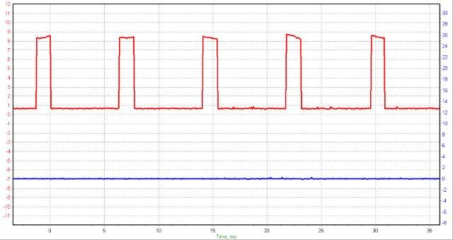

Shot of oscilloscope pattern at 1.28 and 6.40.
Re: Can the GPIO run variable cam phasing?
The code above looks good, but in further testing there was a issue. If you look at the scope trace, it's high for about 17% of the time, and low for the rest. We specified a 17% duty cycle (1.28 on, 6.40 off), so at first glance this looks correct. However, a high voltage on a scope trace when hooked to a transistor's collector means no current is flowing, and a low voltage means current is flowing. So we have things backwards. The problem turns out to be the conditions are backwards for the pin setting assignments we made. We want the pin set high when the counter is in the 'on' range, not the 'off' range. So we change the code to:
