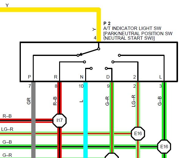

Im also trying to figure out a way to get the input signals right into Mshift so it shows all gears. Ive attached a pic of the shift pattern for my trans. I also have an overdrive button i can use. If anyone has an idea how to wire it up so I have 4 unique inputs instead of 6, Im all ears.
